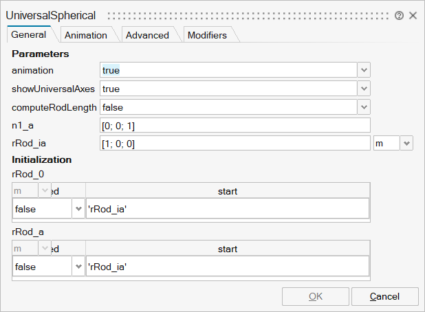

UniversalSpherical_0
mo_animation
animation
= true, if animation shall be enabled
Scalar
true
false
mo_showUniversalAxes
showUniversalAxes
= true, if universal joint shall be visualized with two cylinders, otherwise with a sphere (provided animation=true)
Scalar
true
false
mo_computeRodLength
computeRodLength
= true, if distance between frame_a and frame_b shall be computed during initialization (see info)
Scalar
true
false
mo_n1_a
n1_a
Axis 1 of universal joint resolved in frame_a (axis 2 is orthogonal to axis 1 and to rod)
Vector of size 3
mo_rRod_ia
rRod_ia
Vector from origin of frame_a to origin of frame_b, resolved in frame_ia (if computeRodLength=true, rRod_ia is only an axis vector along the connecting rod)
Vector of size 3

mo_rRod_0
rRod_0
rRod_0
Structure
mo_rRod_0/fixed
fixed
Cell of vectors of size 3
true
false
mo_rRod_0/start
start
mo_rRod_a
rRod_a
rRod_a
Structure
mo_rRod_a/fixed
fixed
true
false
mo_rRod_a/start
start

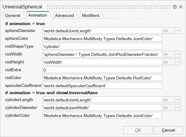

UniversalSpherical_1
mo_sphereDiameter
sphereDiameter
Diameter of spheres representing the universal and the spherical joint
Scalar
mo_sphereColor
sphereColor
Color of spheres representing the universal and the spherical joint
Vector of size 3
mo_rodShapeType
rodShapeType
Shape type of rod connecting the universal and the spherical joint
String
mo_rodWidth
rodWidth
Width of rod shape in direction of axis 2 of universal joint.
Scalar
mo_rodHeight
rodHeight
Height of rod shape in direction that is orthogonal to rod and to axis 2
Scalar
mo_rodExtra
rodExtra
Additional parameter depending on rodShapeType
Scalar
mo_rodColor
rodColor
Color of rod shape connecting the universal and the spherical joints
Vector of size 3
mo_specularCoefficient
specularCoefficient
Reflection of ambient light (= 0: light is completely absorbed)
Scalar
mo_cylinderLength
cylinderLength
Length of cylinders representing the two universal joint axes
Scalar
mo_cylinderDiameter
cylinderDiameter
Diameter of cylinders representing the two universal joint axes
Scalar
mo_cylinderColor
cylinderColor
Color of cylinders representing the two universal joint axes
Vector of size 3

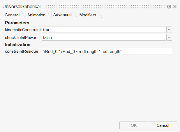

UniversalSpherical_2
mo_kinematicConstraint
kinematicConstraint
= false, if no constraint shall be defined, due to analytically solving a kinematic loop
Scalar
true
false
mo_checkTotalPower
checkTotalPower
= true, if total power flowing into this component shall be determined (must be zero)
Scalar
true
false
mo_constraintResidue
constraintResidue
Constraint equation of joint in residue form: Either length constraint (= default) or equation to compute rod force (for analytic solution of loops in combination with Internal.RevoluteWithLengthConstraint/PrismaticWithLengthConstraint)
Scalar

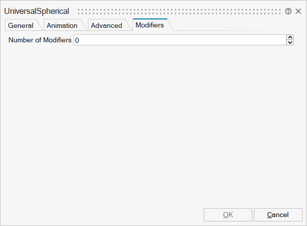

UniversalSpherical_3
mo__nmodifiers
Number of Modifiers
Number
mo__modifiers
Modifiers
Add new modifier
Structure
mo__modifiers/varname
Variable name
Cell of strings
'f_rod'
'totalPower'
