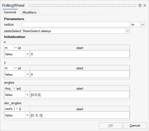

A joint for a wheel rolling on the x-y plane of the world frame.The rolling contact is considered being ideal, i.e. there is noslip between the wheel and the ground. This is simplygained by two non-holonomic constraint equations on velocity leveldefined for both longitudinal and lateral direction of the wheel.There is also a holonomic constraint equation on position levelgranting a permanent contact of the wheel to the ground, i.e.the wheel can not take off.
The origin of the frame frame_a is placed in the intersectionof the wheel spin axis with the wheel middle plane and rotateswith the wheel itself. The y-axis of frame_a is identical withthe wheel spin axis, i.e. the wheel rotates about y-axis of frame_a.A wheel body collecting the mass and inertia should be connected tothis frame.

mo_radius | radius | Wheel radius | Scalar | |
mo_stateSelect | stateSelect | Priority to use generalized coordinates as states | Structure | |
mo_stateSelect/choice1 | StateSelect.never | Number | 0 | |
mo_stateSelect/choice2 | StateSelect.avoid | Number | 0 | |
mo_stateSelect/choice3 | StateSelect.default | Number | 0 | |
mo_stateSelect/choice4 | StateSelect.prefer | Number | 0 | |
mo_stateSelect/choice5 | StateSelect.always | Number | 0 | |
mo_x | x | x | Structure | |
mo_x/fixed | fixed | Cell of scalars | true | |
mo_x/start | start | Cell of scalars | ||
mo_y | y | y | Structure | |
mo_y/fixed | fixed | Cell of scalars | true | |
mo_y/start | start | Cell of scalars | ||
mo_angles | angles | angles | Structure | |
mo_angles/fixed | fixed | Cell of vectors of size 3 | true | |
mo_angles/start | start | Cell of vectors of size 3 | ||
mo_der_angles | der_angles | der_angles | Structure | |
mo_der_angles/fixed | fixed | Cell of vectors of size 3 | true | |
mo_der_angles/start | start | Cell of vectors of size 3 | ||
mo_delta_0 | delta_0 | delta_0 | Structure | |
mo_delta_0/fixed | fixed | Cell of vectors of size 3 | true | |
mo_delta_0/start | start | Cell of vectors of size 3 |

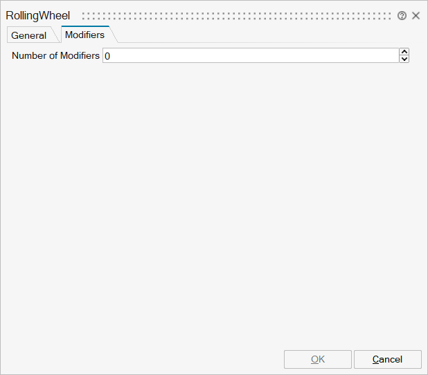

mo__modifiers/varname | Variable name | Cell of strings | 'z' | |
mo__modifiers/value | Value |
