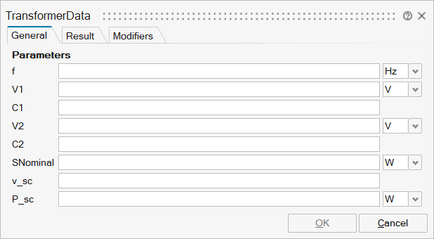

The parameters of the transformer models are calculated from parameters normally given in a technical description.
mo_f | f | Nominal frequency | Scalar | |
mo_V1 | V1 | Primary nominal line-to-line voltage (RMS) | Scalar | |
mo_C1 | C1 | Choose primary connection | String | |
mo_V2 | V2 | Secondary open circuit line-to-line voltage (RMS) @ primary nominal voltage | Scalar | |
mo_C2 | C2 | Choose secondary connection | String | |
mo_SNominal | SNominal | Nominal apparent power | Scalar | |
mo_v_sc | v_sc | Impedance voltage drop pu | Scalar | |

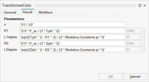

mo_n | n | Ratio primary voltage (line-to-line) / secondary voltage (line-to-line) | Scalar | |
mo_R1 | R1 | Warm primary resistance per phase | Scalar | |
mo_L1sigma | L1sigma | Primary stray inductance per phase | Scalar | |
mo_R2 | R2 | Warm secondary resistance per phase | Scalar | |
mo_L2sigma | L2sigma | Secondary stray inductance per phase | Scalar |

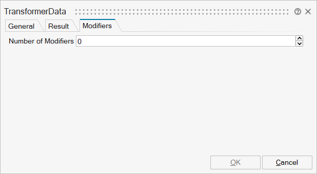

mo__modifiers/value | Value |
