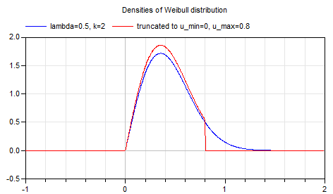

This function computes the probability density function according to a truncated Weibull distribution with minimum value u_min, maximum value u_max, scale parameter of original distribution lambda and shape parameter of original distribution k. Plot of the function:

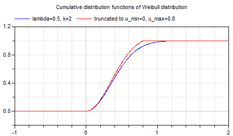

This function computes the cumulative distribution function according to a truncated Weibull distribution with minimum value u_min, maximum value u_max, scale parameter of original distribution lambda and shape parameter of original distribution k. The returned value y is in the range:
0 ≤ y ≤ 1

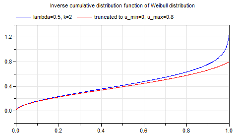

This function computes the inverse cumulative distribution function (= quantile) according to a truncated Weibull distribution with minimum value u_min, maximum value u_max, scale parameter of original distribution lambda and shape parameter of original distribution k. Input argument u must be in the range:
0 ≤ u ≤ 1
Output argument y is in the range:
y_min ≤ y ≤ y_max
