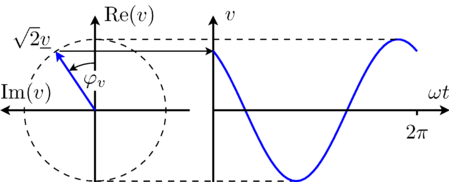

This equation is also illustrated in Fig. 1.
Fig. 1: Relationship between voltage phasor and time domain voltage
From the above equation it is obvious that for t = 0 the time domain voltage is v = cos(φv). The complex representation of the phasor corresponds with this instance, too, since the phasor is leading the real axis by the angle φv.

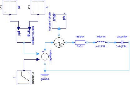

A simple example of a series connection of a resistor, an inductor and a capacitor as depicted in Fig. 1 should be explained in the following. For various frequencies, the voltage drops across the resistor, the inductor and the capacitor should be determined.
Fig. 1: Series AC circuit of a resistor and an inductor at variable frequency

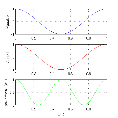

Power of a resistor
The instantaneous voltage and current are in phase:
Therefore, the instantaneous power is
A graphical representation of these equations is depicted in Fig. 1
Fig. 1: Instantaneous voltage, current of power of a resistor
Real power of the resistor is the average of instantaneous power:

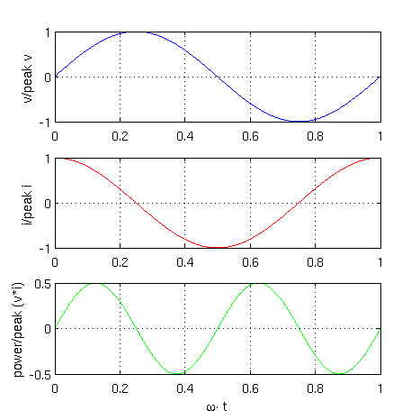

Power of an inductor
The instantaneous voltage leads the current by a quarter of the period:
A graphical representation of these equations is depicted in Fig. 2
Fig. 2: Instantaneous voltage, current of power of an inductor
Reactive power of the inductor is:
