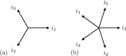

A symmetrical three-phases system consists of three sinusoidal sine waves with an angular displacement of 2 π / 3.
Symmetrical polyphase system
In symmetrical polyphase systems odd and even phase numbers have to be distinguished.
Odd number of phases
For a symmetrical polyphase system with m phases the displacement of the sine waves is 2 π / m.
Fig. 1: Symmetrical (a) three-phase and (b) five-phase current system

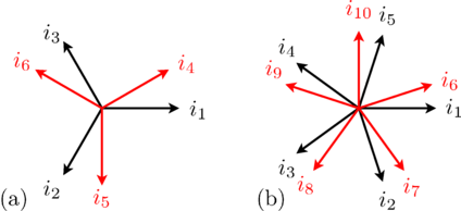

Even number of phases
In case of an even number of phases the aligned orientation does not add any information. Instead the m phases are divided into two or more different groups (the base systems).
The number of phases m can be divided by 2 recursively until the result is either an odd number or 2. The result of this division is called mBase, the number of phases of the base system. The number of base systems nBase is defined by the number of divisions, i.e., m = nBase * mBase.
For a base system with mBase phases the displacement of the sine waves belonging to that base system is 2 π / mBase.
Fig. 2: Symmetrical (a) six and (b) ten phase current system
The displacement of the base systems is defined as π / nBase.

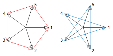

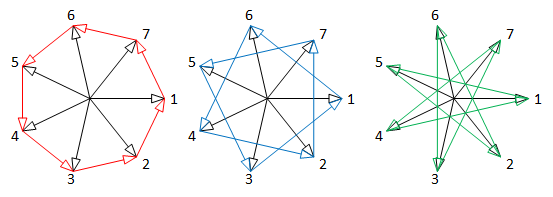

For polyphase systems, star connection of the m phases is unambiguous, i.e., each pin of the plug is connected to the starpoint pin, whereas for polygon connection (mBase - 1)/2 alternatives exist (refer to Fig. 3).
Fig. 3: Line-to-neutral voltages and line-to-line voltages for different systems
2 phase system 2 = 2 x 2 phase system
3 phase system 6 = 2 x 3 phase system
5 phase system: 2 alternative polygon connections 7 phase system: 3 alternative polygon connections
Therefore, using the MultiDelta component, the alternative has to be specified by the parameter kPolygon.
