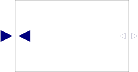

Block Modelica.Blocks.Math.InverseBlockConstraints
Exchange input and output signals of a block, i.e., the previous block inputs become block outputs and the previous block outputs become block inputs. This block is used to construct inverse models. Its usage is demonstrated in example: Modelica.Blocks.Examples.InverseModel.
Note, if a block shall be inverted that has several input and output blocks, then this can be easily achieved by using a vector of InverseBlockConstraints instances:
InverseBlockConstraint invert[3]; // Block to be inverted has 3 input signals
| Type | Name | Description |
input RealInput | u1 | Input signal 1 (u1 = u2) |
input RealInput | u2 | Input signal 2 (u1 = u2) |
output RealOutput | y1 | Output signal 1 (y1 = y2) |
output RealOutput | y2 | Output signal 2 (y1 = y2) |

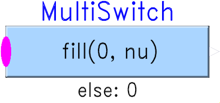

Block Modelica.Blocks.Math.MultiSwitch
This block has a vector of Boolean input signals u[nu] and a vector of (time varying) Real expressions expr[nu]. The output signal y is set to expr[i], if i is the first element in the input vector u that is true. If all input signals are false, y is set to parameter "y_default".
// Conceptual equation (not valid Modelica) i = 'first element of u[:] that is true'; y = if i==0 then y_default else expr[i];
The input connector is a vector of Boolean input signals. When a connection line is drawn, the dimension of the input vector is enlarged by one and the connection is automatically connected to this new free index (thanks to the connectorSizing annotation).
The usage is demonstrated, e.g., in example Modelica.Blocks.Examples.RealNetwork1.
| Type | Name | Default | Description |
Real | y_default | 0 | Default value of output y if all u[i] = false |
Integer | nu | 0 | Number of input connections |
Integer | precision | 3 | Number of significant digits to be shown in dynamic diagram layer for y |
Real | expr[nu] | fill(0, nu) | y = if u[i] then expr[i] else y_default (time varying) |
input BooleanVectorInput | u[nu] | Set y = expr[i], if u[i] = true |
output RealOutput | y | Output depending on expression |
