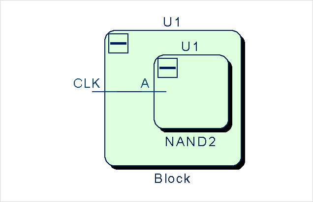

Object Identification
Individual "Objects" can be selected by mouse or highlighted or addressed through the Database API (for more information, please check out the Object Identification (OID) API and this UML diagram). All the GUI’s communication features like Drag & Drop, the Goto function, all kind of selection and highlighting, and especially the Memory and Search windows internally base on these Object IDs.
The image above shows an Instance of a Module, one Primitive Instance, two Device Instances, an input and an output Port, an input PortBus, Pins and a PinBus and some Nets and a NetBus.
The basic Object types are:
Instance - the instance of a Module or a Primitive.
Pin - an instance pin (refers to a Module/Primitive Port).
PinBus - an instance bus-pin (refers to a Module/Primitive PortBus).
Port - a Module/Primitive interface port.
PortBus - a Module/Primitive interface bus-port.
Net - a single-bit net connecting pins (and eventually a port).
NetBus - an array of nets.
Primitive - defines the Cell’s primitive function and the interface (not selectable in Schem or Cone windows).
Module - defines the interface and contents of a hierarchical block (not selectable in Schem or Cone windows).

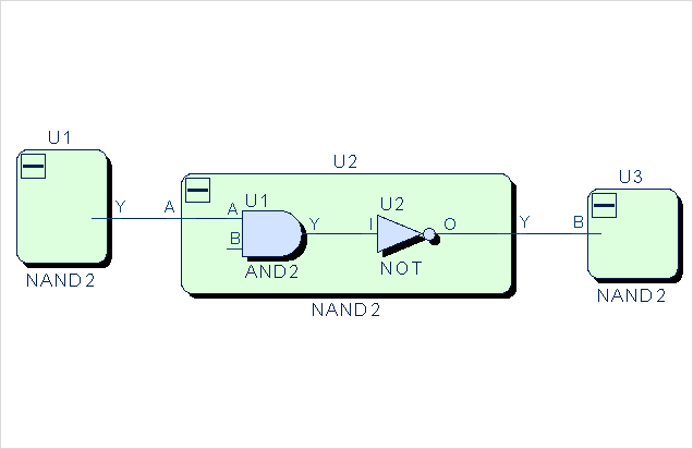

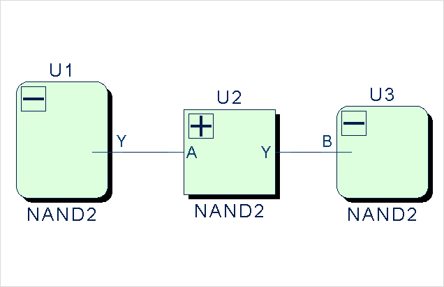

Unfold the hierarchy box to see the contents.  |
Ctrl+U  |
Fold the hierarchy box to hide the contents.  |
Ctrl+F  |
Ctrl+U  |
Ctrl+F  |

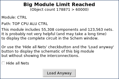

If the module is larger than the page size you selected in Preferences it must be split into different pages. Splitting is done automatically. See below, how to change between the different pages. If the module to be displayed exceeds the limit set in Preferences, a dialog box is presented.

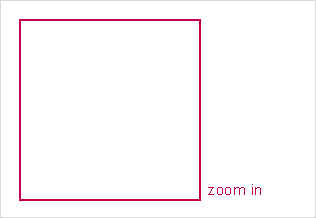

 Use the stroke mouse button to drag a rectangular (zoom) area.
Start dragging from top left corner and stop dragging in the bottom right corner of the area to be zoomed in.  |

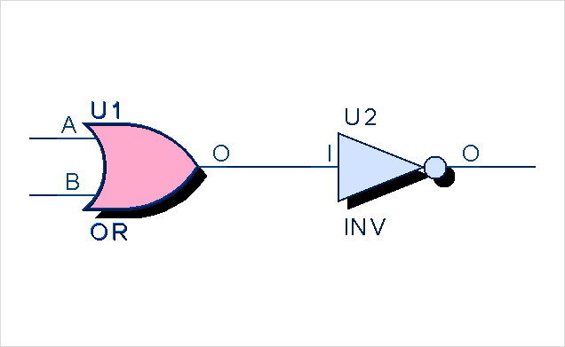

 Single-click any visible object in the window with the left mouse button. Selected objects have a thicker borderline.  |
none  |
 Keep the Ctrl-key pressed while single-clicking any visible object in the window with the left mouse button. If the object was already selected, it will become deselected.  |
none  |

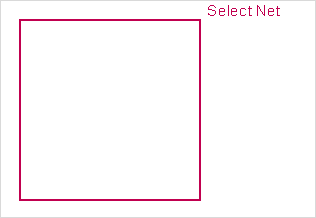

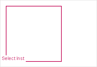

select multiple objects  |
Keep the Shift-key pressed while dragging the mouse with the stroke mouse button pressed down to open a rectangular area.  |

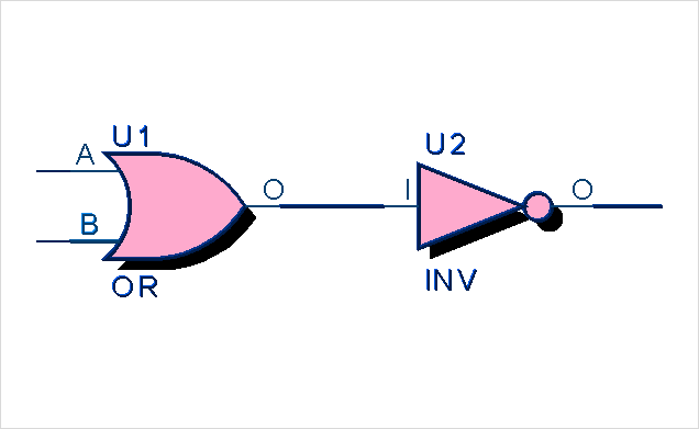

highlight  |
accessible via context menu - it will highlight the current selection.  |
Ctrl+H  |

 Double-click with the left mouse button on the border of an instance to turn the autohide feature 'on'. Autohide causes (temporarily and permanently) unconnected instance pins to be hidden automatically (until they are connected to a 'loaded', i.e. visible, net). Alternatively, you may also set the 'Hide Unconnected Pins' option either in the toolbar of the Cone window or in the Cone tab of the Preferences dialog.  |
none  |
autohide off  |
 Double-click with the left mouse button on the border of an instance to turn the autohide feature 'off'.  |
none  |
 The content of the selected hierarchy boxes is hidden thus the boxes look empty.
This can be quite useful after a cone extraction to reduce the amount of details displayed in cone.  |
Ctrl+F  |
unfold  |
 The content of the selected folded hierarchy boxes is shown again.  |

Expand Modules Inline - Expand the contents of modules inline in the current module using the (+) button in the top left corner.
[schem:expandInline] -

Big Module Limit - Before the schematic of a module is generated the number of objects the module contains is compared with the number specified here. If the number of components in the module is less than this limit, the schematic is generated without user interaction.
Increase this number for fast computers and decrease it for slower machines.
This value is also used as a limit if you load heavy connected Nets/Signals to the Cone window using from the context menu.
A value of0disables the limit. The default value is 60,000.
[bigModuleLimit] -
