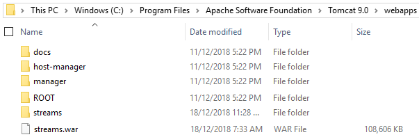

- Copy the streams.war file into the Tomcat webapps folder (\Apache Software Foundation\Tomcat 10.0\webapps).
- Start Tomcat to deploy the .war file.
The streams folder is extracted in the Tomcat webapps folder:

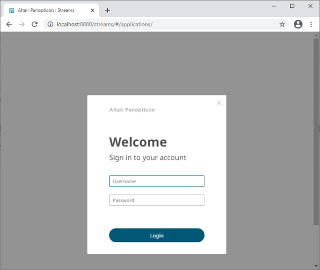

- You should now be able to log on to Panopticon Streams using the following URL:
[Host Name]:[Port]/[Name of your application]
For example:
http://localhost:8080/streams
