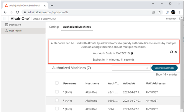

Use an authorization code generated through Altair One:
  1.  Log on to Altair One (https://admin.altairone.com) then navigate to User Profile and select Authorized Machines.
  2. Click  .
    The page displays the auth code and a timer indicating the code’s expiration.
    Click Copy to Clipboard  to copy the generated auth code.
  3.  Paste the generated code into the license.hwu.hosted.authorization.token property in the Streams.properties file.
  4. Start the server.
