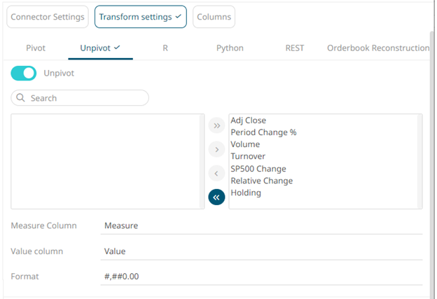

  1. To unpivot the data, click the Transform Settings button on the Data Sources Setting pane.
    The Transform Settings pane displays.
  2. Click  .
    The Transform Settings pane changes to display the Unpivot Settings.
  3. Tap the Unpivot slider.
    The Transform Settings button and Unpivot tab change to  and    , respectively and all of the columns are moved to the Unpivot box.
    You may opt to move fields from the Columns to Unpivot box, or vice versa, using the following buttons:
    •  - move all fields from the Columns to Unpivot box
    •  - move all fields from the Unpivot to Columns box
    •  - click after selecting one or more fields from the Columns box to move to the Unpivot box
    •  - click after selecting one or more fields from the Unpivot box to move to the Columns box
    You can also filter the list of columns by entering a text in the Search Columns search box.
  4. Give appropriate names to the Measure and Value columns.
    For example:
    Measure Column = Return Type
    Value Column = Return Value
  5. Define the display formats for numeric fields. The default setting is: #,##0.00
  6. Refer to Enable Time Series Analysis for more information in enabling this feature.
    Enabling the time series analysis when you perform an unpivot solves the problem of having to specify all of the values. It also allows you to choose which Time column should be used to specify the time series.
  7. Click  .
