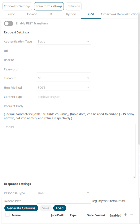

- Click the Transform Settings button on the Data Sources Setting pane.
The Transform Settings pane displays.
- Click
The Transform Settings pane changes to display the REST Transform Settings.
- Tap the Enable REST Transform slider.
The Transform Settings button and REST tab change to
and
, respectively. - On the Request Settings section, define or select the following required properties:

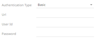

Basic
Enter the URL of the REST API. Then enter the User Id and the Password that will be used to the connect to the REST API.

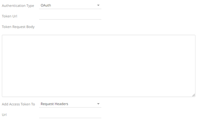

OAuth
Then enter the following settings:
Token URL – The URL to retrieve the access token from.
Token Request Body – The request body used for access token requests.
Add Access Token To - The Access token retrieved from the Token URL can be added to headers, URL or request body, depending on how the REST endpoint needs the token.
Request Header - A header is automatically added to the REST API request.
Request URL - The URL needs to be manually parameterised with a {access_token} parameter, before calling the REST API, the parameter is replaced with the actual token.
Request Body - The Request Body needs to be manually parameterised with a {access_token} parameter, before calling the REST API, the parameter is replaced with the actual token.
URL – The URL of the REST API.

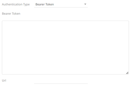

- Bearer Token
If you already have an authentication token, enter the token string into Bearer Token input box. Then enter the URL of the REST API.

- Enter the Request Body.
The request body is required to always be JSON formatted. The request body JSON should be structured to conform with what the target REST API is expecting. To the extent that the REST API you are using supports it, you can include any values or Panopticon parameter references in the request body. There are three special parameters to use for referencing the dataset you send as part of your request:

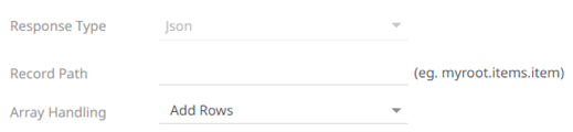

- JSON
If JSON is selected, enter the Record Path which allows the identification of multiple records within the JSON document (e.g., myroot.items.item) and select the Array Handling setting.

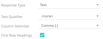

- Text
If Text is selected, confirm the Text Qualifier, Column Delimiter, and if the first row of the message includes column headings.
The Column Index controls the position of a column, ensure the value is >= 0.
