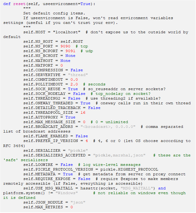

    Modify the configuration.py  file located in ..\Anaconda3\Lib\site-packages\Pyro4 to specify the serialization to be used.
    For example, if Pickle is selected, self.SERIALIZER value should be changed to pickle and self.SERIALIZERS_ACCEPTED  value should be changed to include pickle:

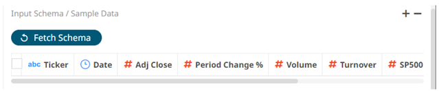

  7.  On the Input Schema/Sample Data section, the column names of the input data source are displayed.
    In cases where there are no rows from the input data source and the Python script is not handling zero rows, you can add sample data to ensure transform is applied.
    To add or manage the sample data, you can use the following icons:
    Icon Description
    Add sample data for the input column names.
    Check a box of a sample data row and click   to delete or check the topmost  box and click  to delete all of the sample data rows.
