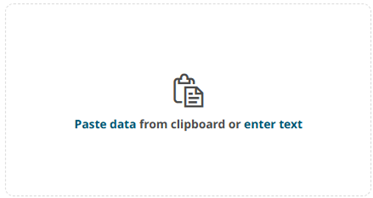

  1. You can do one of the following:
    • Click Paste data to open the Connector Settings pane with the data pasted. You can proceed to pasting more data.
      NOTE: The Paste Data feature will only work when the page is running over SSL (HTTPS), with localhost being an exception. See Browser Compatibility for more information.
    • Click Enter text to open the Connector Settings pane to start typing data.
    NOTE: Press Shift + Enter to apply and display the preview of the changes in the typed or pasted data.

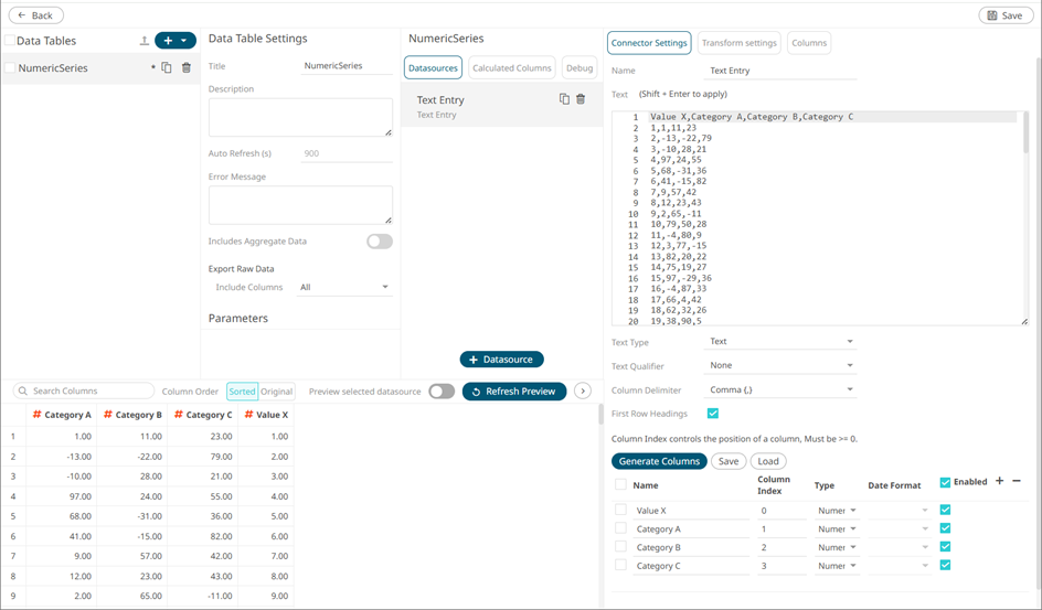

    For example, here is the initial configuration for the pasted text.
    NOTE: Connectors that use the Text parser support automatic discovery of Text Qualifier and Column Delimiter.
  2. Select the Text Type.
  3. Click   to the fetch the schema based on the connection details. Consequently, the list of
    columns with the data type found from inspecting the first ‘n’ rows of the input data source is populated and the Save button is enabled.
  4. You can also opt to load or save a copy of the column definition.
  5. Click    to add columns and specify their properties:
