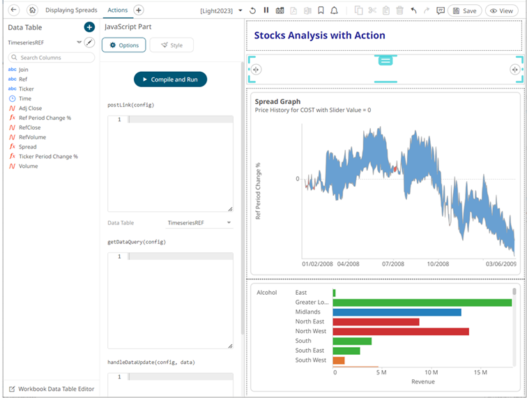

- After double-clicking or drawing a rectangle on the dashboard canvas, scroll to the General section of the Part Types pane and select JavaScript Part
The JavaScript pane is displayed, and the JavaScript part is added on the dashboard canvas.
The JavaScript part settings support the following functions:
- postLink(config)
- getDataRequestObject(config)
- handleDataUpdate(config, data)
The argument config in all of the three functions will be an object with a single property element. config.element is the DOM element that is to be used if a UI is required. The same instance of config will be used throughout the lifetime of the JavaScript dashboard part. This means it can also be used to save references to other DOM elements, functions, or data.
- Define the functions, as required:
- postLink(config) is called after the dashboard part is added to the DOM. The function can optionally return a destroy function. The return value is called when the dashboard part is disposed and removed from the DOM. This will happen when the user switches to another dashboard. Note that this is the only function that is required to implement this dashboard part.
Then select the Data Table.
- getDataRequestObject(config) is optional and only used if the dashboard part needs to load data. The function specifies which columns to load, aggregation, and the shape of the data. The data table used for the dashboard part is selected from the Designer, in the drop-down list.
- handleDataUpdate(config, data) is the callback used when the data has finished loading from the Panopticon Real Time. If the data table consists of a real time data source, then this function will be called for each update from Panopticon Real Time.

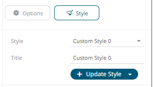

- To set the style of the JavaScript part, click Style
The page updates to display the Style pane.
See Defining the Style of General Parts for more information.
- Click Update Style
and select any of the following options:
- Set current as default – Save the changes and set it as the default.
- Create custom style – Save the changes and set it as a custom style.
The Style pane updates to display the Title control.
- Enter the custom style's Title.
- If there are additional changes made, click Update Current Style in the Update Style drop-down.
The new custom style is added to the Workbook > Theme > Custom Styles list.
If published, the custom style configuration of the JavaScript part will be added to the Global custom styles list and can be applied to other parts.
