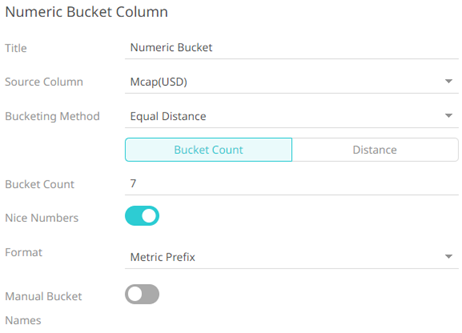

- Click New Column > Numeric Bucket.
The numeric bucket instance is displayed on the Data Sources Settings with Numeric Bucket as the default title, also the Numeric Bucket Column pane displays.
You may opt to modify the numeric equal distance bucket's Title.
- Select the numeric Source Column.
- Select Equal Distance in the Bucketing Mode drop-down list box.
- Select one of the following modes:
Equal Distance Mode Description Bucket Count
The number of buckets. This is the default mode, and the value can be parameterized.
You can also set the following for this option:

- Tap the Manual Bucket Names slider then enter the bucket names depending on the number of buckets you specified.
