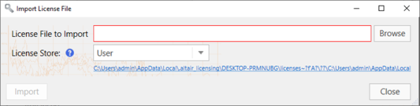

Select the Activation tab in the Altair Units License Configuration screen and then click the Import License File button.
Use the dialog that displays to navigate to the folder containing your license file and select it.
Select the appropriate license store from the options provided. The license store type defines the scope and storage folder for activated licenses.
Selecting User saves the license to the “C:\Users\[User]\AppData\Local\.altair_licensing\[ComputerName]\licenses” folder.
Selecting System saves the license to the “C:\ProgramData\altair\licenses” folder.

Click the Import button and, when the dialog closes, click the Connect button.
Monarch is successfully activated.
