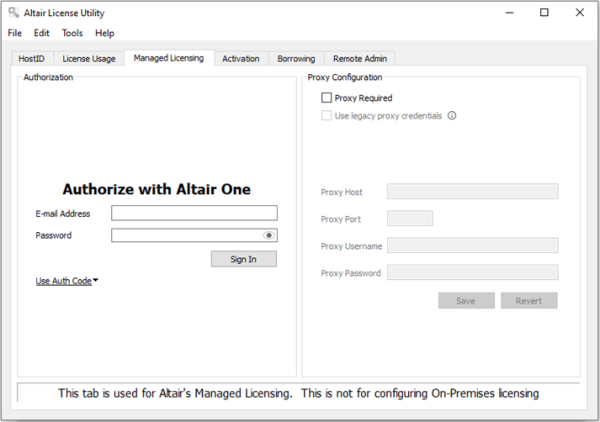

Managed Licensing
To activate Monarch via Managed Licensing, click the Managed Licensing tab of this utility and then provide the necessary details.

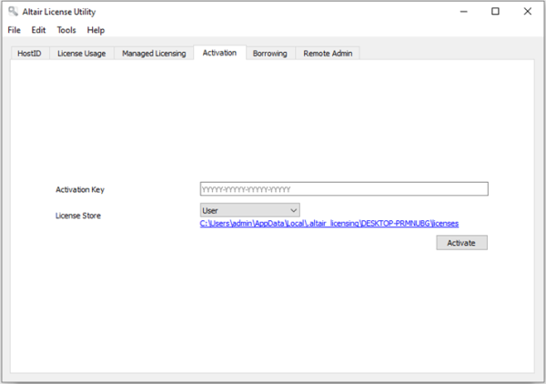

Activation Key
To activate Monarch using an Altair Activation Key, click the Activation tab and provide the Activation Key. Select a License Store location and then click Activate.

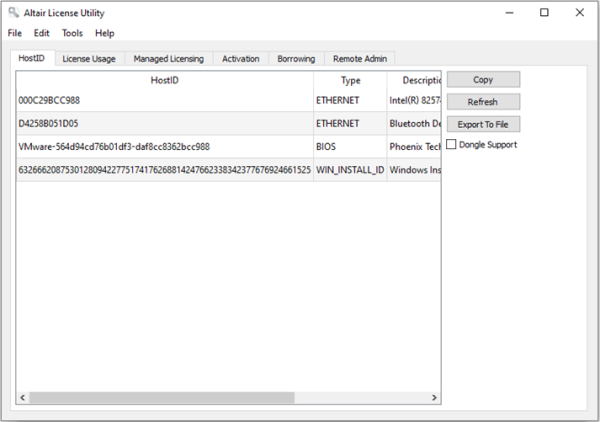

  1. Generate a HostID file for Machine A. A HostID is a unique machine value that can be used to lock a license file to a specific host.
    In Machine A, select the HostID tab of the Altair License Utility and then click the Export to File button. Your HostID details are saved to an XML file at a location of your choosing. This location must be accessible to Machine B.

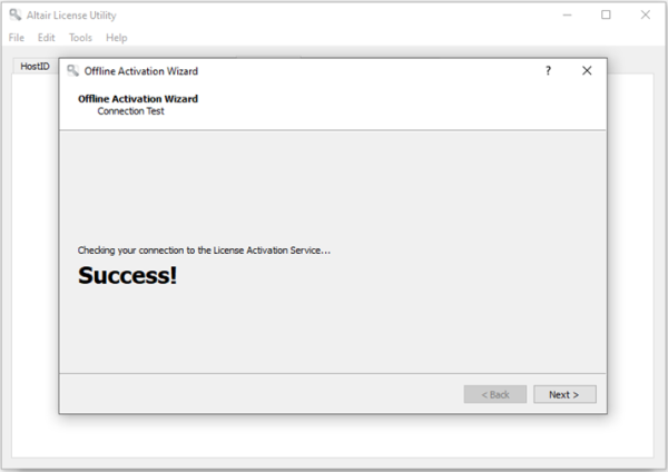

  2. Generate a license file for Machine A.
    In Machine B, launch the Altair License Utility and then select Tools > Offline Activation Wizard. The wizard displays, and your connection to the License Activation Service will be checked.
  3. Click Next and then follow the prompts that display. When asked to supply the HostID file, use the file generated in Step 1.

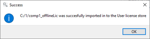

  5. In Machine A, select Tools > Import License File in the Altair License Utility toolbar.
  6. Navigate to the location of the license file generate in Step 4 and select a store location. Click Import when you are finished.

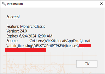

    If the result is positive, a popup displays.
