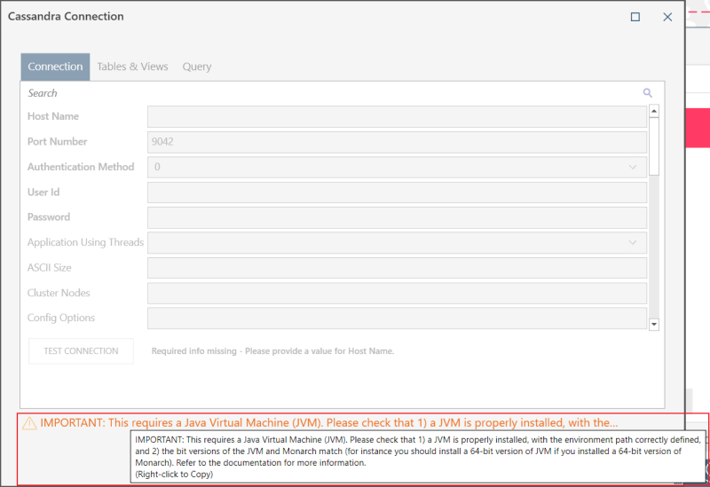

If the required JVM has not been properly configured and the connector is selected from the connectors list, its corresponding dialog displays but is grayed out. A warning line also appears; the full details of this warning can be viewed by hovering your cursor over the line.
