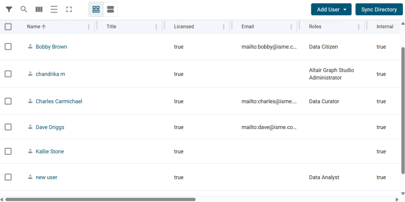

  1. In the Administration application, expand the User Management menu and click Users. Graph Studio displays the Users screen, which lists the existing users. For example:

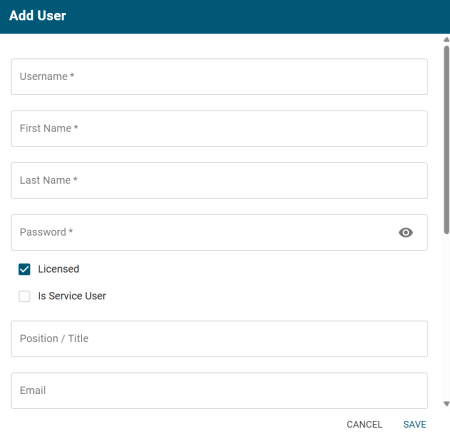

  2. On the Users screen, click the Add User button and select Create New User. Graph Studio opens the Add User dialog box.
  3. Complete the required fields and enter any optional user details:
    • Username: The user name that the user will use to log in to Graph Studio.
    • First Name: The user's first name.
    • Last Name: The user's last name.
    • Password and Confirm Password: Type a password for the user.
    • Licensed: Select the Licensed checkbox if you want this user to be able to log in to the Graph Studio applications. If you want to add this user to the system but do not want to give them access to Graph Studio applications at this time, clear the Licensed checkbox.
    • Position/Title: The user's job title or position.
    • Email: The user's email address.
    • Phone: The user's phone number.
    • Roles: The role or roles that the user is a member of. Roles define the user's level of access to Graph Studio applications and features. Click the Roles field and select a role from the drop-down list. Click the field again to select additional roles.
  4. When you have finished configuring the user account, click Save to add the user to the system.
