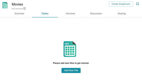

- Specify a name for the Data Source in the Title field, and type an optional description in the Description field. Then click Save. Graph Studio saves the source and displays the Tables tab.

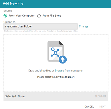

- Click the Add New File button. Graph Studio displays the Add New File dialog box.
- Follow the appropriate steps below depending on whether the CSV files are on your computer or the shared File Store:

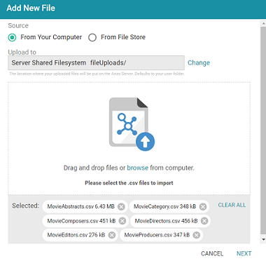

If the files are on your computer:
The From Your Computer option is a convenient way to do a one-time ingestion so you can quickly get started with your data. It should not be relied upon as part of a regular onboarding workflow unless the server is configured to store uploaded files on the shared file store as described in Setting the Default File Upload Path. Data source files that are routinely updated and re-ingested should be hosted on a shared file store.
- As a best practice, check the upload location that is listed in the Upload To field by hovering your pointer over the value to view the tooltip. Make sure the upload location is a directory on the shared file store and not in the server installation path. If the file is not uploaded to the shared file store it is not accessible by applications like Graph Lakehouse. In addition, other users cannot create graphmarts from the data source because they typically do not have access to the file location.
For example, viewing the Upload To location for the screen above shows that the file will be uploaded to the server installation path,
/opt/Anzo/Server/data...
If your Upload To location is configured to upload the file to the server installation path, click Change and select an upload location that is on the shared file store. For example, the image below shows the Upload Folder Location dialog box that is presented after clicking Change. A folder called fileUploads is selected on the shared store.
- Drag and drop the files onto the screen or click browse to navigate to the files and select them. Graph Studio attaches the files and the Next button becomes active. For example:

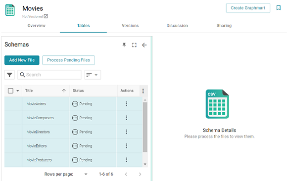

- Click Next. Graph Studio lists the uploaded files on the left side of the screen with a status of Pending. For example:

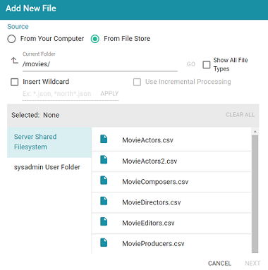

If the files are on the File Store:
- Click the From File Store radio button. Graph Studio displays the file selection dialog box. For example:
- On the left side of the screen, select the file store that hosts the CSV files. On the right side of the screen, navigate to the directory that contains the files to import. The screen displays the list of files in the directory.

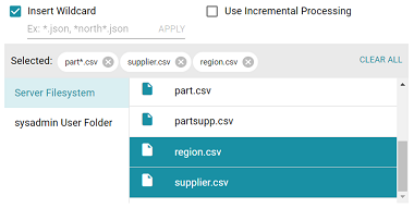

- Select each file that you want to import. If you have multiple files with the same schema— the files contain the same columns listed in the same order—and you want the files to be imported as if they are a single file, you can select the Insert Wildcard option. Then type a string using asterisks as wildcard characters to find the files with similar names. Files that match the specified string will be imported as one file. After typing a string, click Apply to include that string in the Selected list.
The image below shows a directory with several CSV files. For this example, part.csv and partsupp.csv have the same schema and can be imported as one file. The Insert Wildcard option is selected, and part*.csv is specified to identify the two files.
- When you have finished selecting files, click Next to close the dialog box. Graph Studio lists the uploaded files on the left side of the screen with a status of Pending. For example:
- If you do not need to change CSV file options, click the Process Pending Files button to import all of the pending files. Graph Studio imports the data and updates the status to Processed.

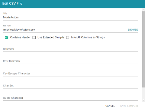

If you do need to change CSV file options, click the menu icon (
) in the Actions column for that file and select Edit. To change the options for multiple files, select the checkbox next to each file, and then click the Edit button at the bottom of the table. Graph Studio displays the Edit CSV File screen. For example, the image below shows the Edit screen for a single file:
Change the options as needed and then click Save & Import to import the file or files. Graph Studio imports the data and updates the status to Processed.

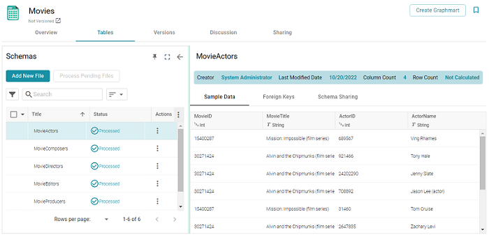

- Once the files are processed, you can click a table row on the left side of the screen to display the schema on the right side of the screen.
The automated data load workflow ignores all changes that are made to the schema on the Tables screen—except for changes to primary and foreign keys. For example, if you edit a column heading to change its semantic type, that change is disregarded when the graphmart is created. Only the original type from the data source is considered. If you add or change primary and foreign keys on the Tables screen, however, the automated data load workflow will retain those changes.
