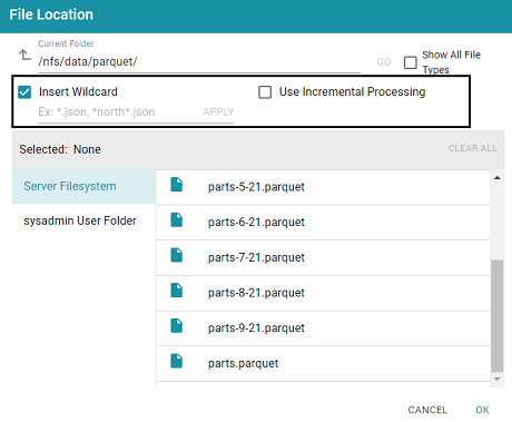

  1. When selecting the source files on the file store, select the Insert Wildcard checkbox. Enabling the wildcard option activates the Use Incremental Processing option.

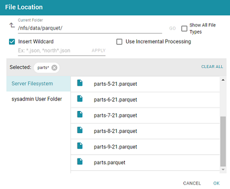

  2. Below the checkbox, type a string using asterisks (*) as wildcard characters to find the files to be processed. Then click Apply to apply the string. If you are configuring a CSV data source, you can apply multiple wildcard strings to target files with different schemas. The image below shows an example for a Parquet source. The string parts* is applied to select all of the files with names that start with "parts."

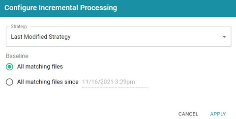

  3. Next, select the Use Incremental Processing checkbox. The Configure Incremental Processing dialog box is displayed:
  4. Click the Strategy drop-down list and select the strategy to use for incremental processing. The following list describes the options. For more details about the strategies, see Incremental Processing Overview above.
    • File Name Strategy: Select this option if file names should be used to target the new source data to process each time the graphmart that contains this source is reloaded or refreshed.
    • Last Modified Strategy: Select this option if the last modified date should be used to target the new source data to process each time the graphmart that contains this source is reloaded or refreshed.
  5. If you chose File Name Strategy, click Apply and then click OK or Next to proceed. The source is now configured to process data incrementally. If you chose Last Modified Strategy, proceed to the next step.
  6. If you chose Last Modified Strategy, the Baseline options are displayed. The Baseline determines when the last modified date begins.
  7. By default All matching files is selected as the Baseline. This means all files in the directory that are matched by the wildcard string will be ingested when the graphmart is reloaded or refreshed. If you have older files that you do not want to be ingested, you can select All matching files since. Then click the timestamp field and specify the date and time to use as the Baseline.
  8. When you have finished configuring the Strategy, click Apply. Then click OK or Next to proceed and finish configuring the data source if necessary.
