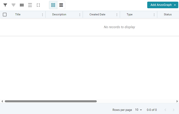

  1. In the Administration application, expand the Connections menu and click Graph Lakehouse. The Graph Lakehouse connection overview screen is displayed, which lists any existing connections. For example, the following image shows the Graph Lakehouse screen before any instances are connected:

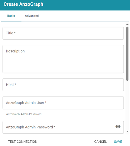

  2. On the Graph Lakehouse screen, click the Add Graph Lakehouse button and select Add Graph Lakehouse from the drop-down list. The Create Graph Lakehouse dialog box is displayed and the Basic tab is selected.
  3. On the Basic tab, type a name for the instance in the Title field. You can also add a description of this connection in the optional Description field.
  4. In the Host field, type the Graph Lakehouse server host name or IP address. If you are connecting to a cluster of nodes, type the name or IP address of the leader server.
  5. In the Graph Lakehouse Admin User field, type the username for the Admin user that was created when Graph Lakehouse was installed.
  6. Then type the password for the Admin user in the Graph Lakehouse Admin Password and Confirm Graph Lakehouse Admin Password fields.
  7. Next, in the Graph Lakehouse Query User field, type the username for the user who can run queries against Graph Lakehouse. Typically administrators enter the same username as the Admin user since the Admin user can run queries.
  8. Then type the password for the Query user in the Graph Lakehouse Query Password and Confirm Graph Lakehouse Query Password fields. Again, this is typically the password for the Admin user.
  9. If this Graph Lakehouse instance will connect to Elasticsearch, click the Elasticsearch Configuration drop-down list and select the Elasticsearch instance to use with this Graph Lakehouse connection. For information about configuring an Elasticsearch connection, see Connecting to Elasticsearch.
  10. Click Test Connection to check if Graph Studio can connect to Graph Lakehouse. If the connection fails, make sure that Graph Lakehouse is running and that you entered the correct connection information as well as usernames and passwords.

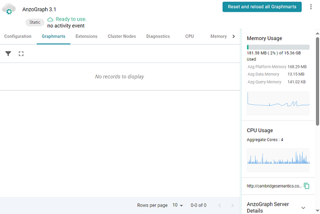

  12. Click Save to save the configuration. Graph Studio connects to Graph Lakehouse and displays the Graphmarts tab. For example, the image below shows a newly created connection.
To change configuration details, click the Configuration tab and adjust values as needed. The right side of the screen shows memory and CPU usage as well as server and graphmart details.
