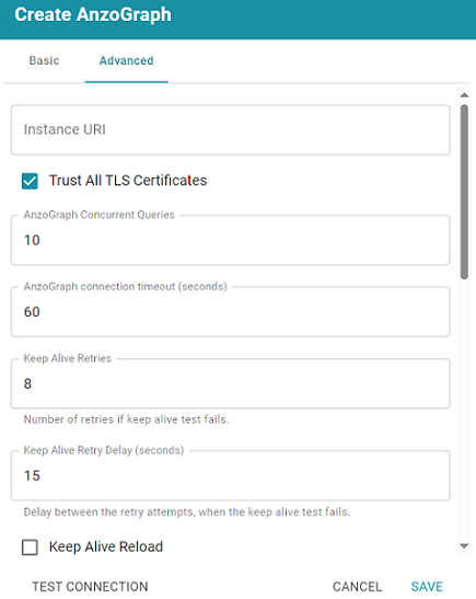

This topic describes the connection settings that are available on the Advanced tab when you add a static Graph Lakehouse connection or the Configuration tab when you edit an existing connection.
Setting Description
Instance URI Defines the URI for this Graph Lakehouse instance. When this setting is empty Graph Studio automatically assigns an instance URI. If you specify a custom URI, make sure that the URI is valid and unique.
Trust All TLS Certificates Indicates whether Graph Studio should trust the Graph Lakehouse certificates for this connection. Altair recommends that you accept the default value of enabled.
Graph Lakehouse Concurrent Queries Specifies the maximum number of queries that Graph Studio can send to Graph Lakehouse concurrently. The default value is 10 queries. Altair recommends that you accept the default value. If you want to increase the number of concurrent queries, Altair recommends that you choose a value between 10 and 20.
Graph Lakehouse Connection Timeout Controls how often (in seconds) Graph Studio checks the status of the connection to this Graph Lakehouse instance. The connection is tested every N seconds, where N is the value of this setting. The default value is 60. If the test fails, Graph Studio re-tests the connection every 15 seconds for 2 minutes to rule out a brief network glitch. If the connection continues to fail after 2 minutes, the status is changed to "Offline." If the connection is re-established within the 2-minute window, Graph Studio determines whether the connection came back automatically or whether Graph Lakehouse was restarted.

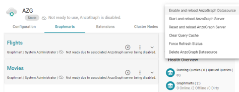

Keep Graph Lakehouse Datasource Enabled on Anzo Startup This option is enabled by default and means that Graph Studio leaves the Graph Lakehouse data source online in a "Ready to use" state if Graph Studio is restarted (if this data source is online at the time Graph Studio is restarted). When this option is disabled, Graph Studio disables this data source when Graph Studio is restarted. When Graph Studio comes online, this source must be manually enabled by selecting Enable and reload Graph Lakehouse Datasource from the menu on the Graph Lakehouse administration screen. For example:
