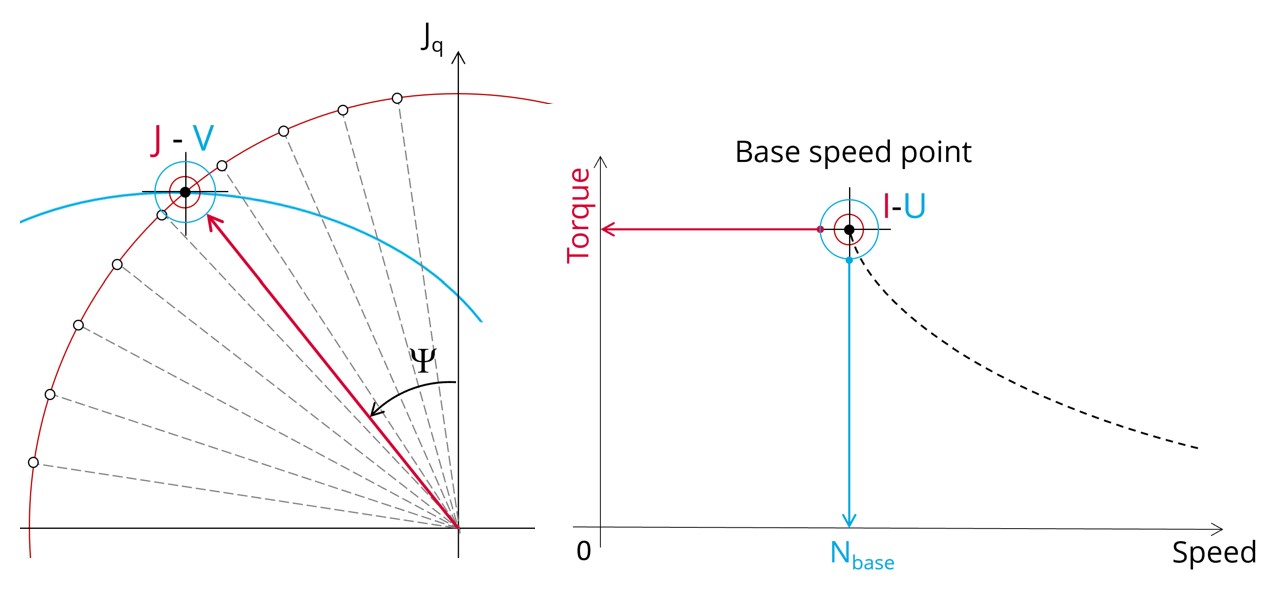

The working point or base speed point of the torque-speed curve is defined by considering the maximum allowed line-line voltage and the maximum allowed line current.
Note: In FluxMotor terminology, the last working point on the constant torque part of the torque-speed curve is called “Base speed point” only when it is obtained for the maximum allowed line-line voltage and the maximum line current. If it is not the case, we called as “Corner speed point”.
Figure 1. Characterization of the base speed point on the torque speed curve
