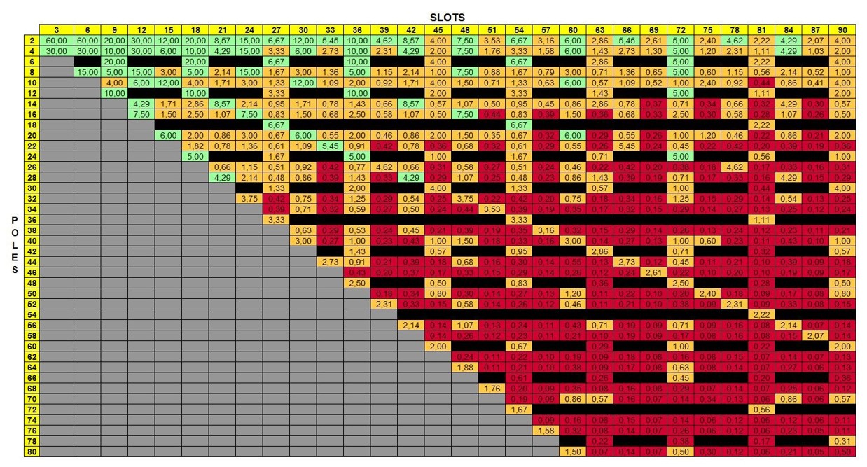

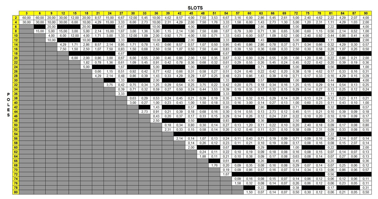

In general, with increasing number of slots and poles, cogging torque period decreases as shown in the following table.
Figure 1. Cogging torque period in mechanical degrees
Note: An extremely small cogging torque period implies the need of a very thin mesh to get accurate results (by using a low airgap mesh coefficient value – See advanced parameter definition). Thus, the number of elements in the corresponding model will be very high (it means a high mesh density).

For information, the following table gives a general idea of easy computations (green cells), difficult ones (orange cells) and in some instances impossible ones (red cells) in FluxMotor.
Figure 2. Cogging torque computation: Green= easy / Orange = difficult / Red = very difficult or even impossible

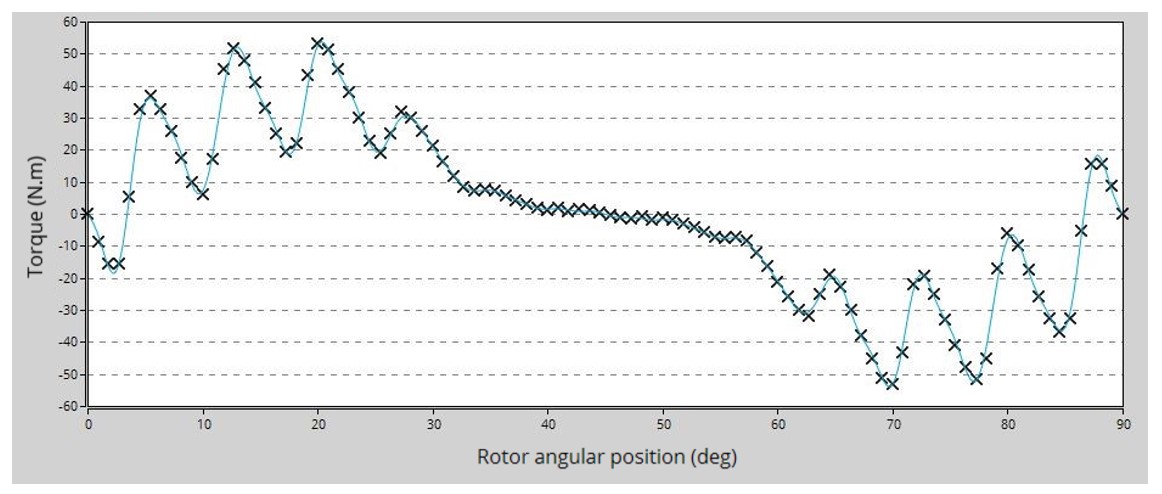

To be noted that in case of square shape lamination, the analysis of the cogging torque will be done at least over 90 mechanical degrees (see the following example).
Figure 3. Cogging torque analysis over 90 mechanical degrees
