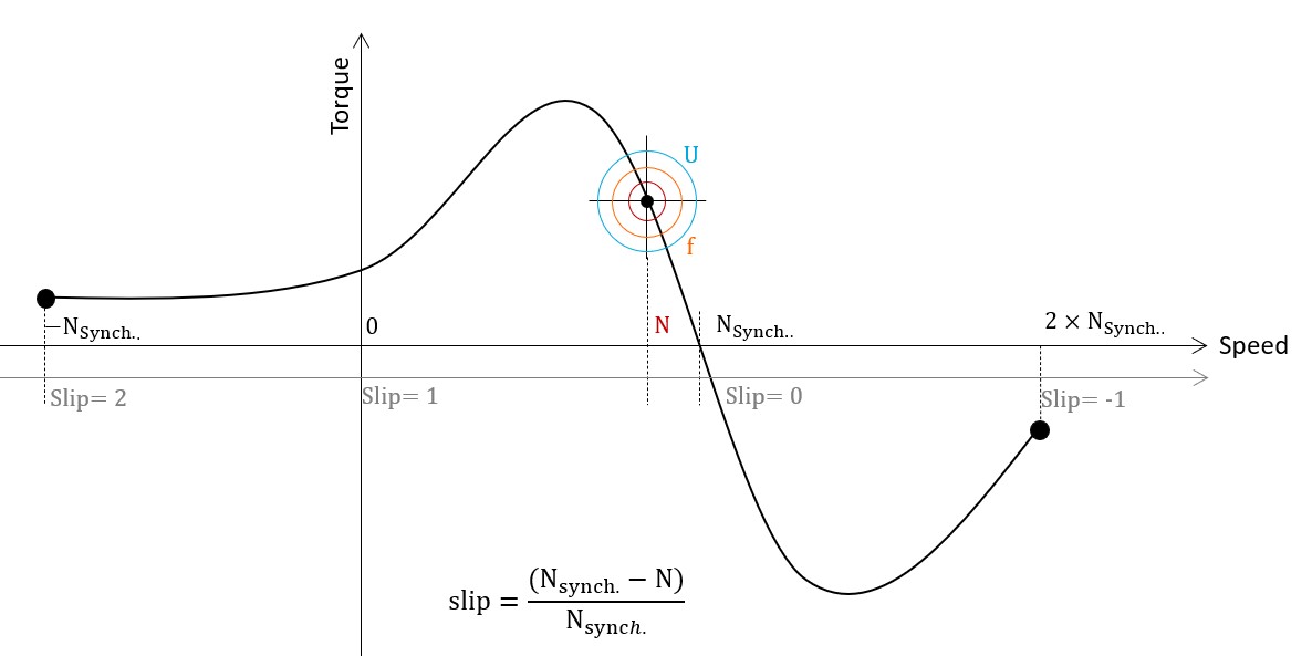

The aim of the test “Working point – Sine wave – Motor – U, f, N” is to characterize the behavior of the machine when operating at the targeted input values U, f, N (Magnitude of line-line voltage, Power supply frequency, Speed).
These three inputs are enough to impose a precise working point.
For instance, a working point can be chosen on a torque slip curve, by identifying the voltage, the power supply frequency and the speed with different curves displayed in the “Performance mapping / Sine wave / Motor / T-S” test. Then, the “Working point – Sine wave – Motor – U, f, N” test allows to compute the motor performance for this chosen working point.
Figure 1. “Working point – Sine wave – Motor – U, f, N” Illustration
