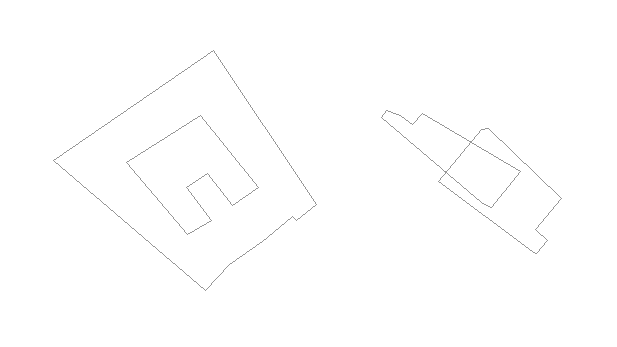

The immediate check of new objects verifies whether new objects or modified objects overlap other objects.
Figure 2. Complete and partial overlapping.
We have to distinguish between indoor and urban databases:- Indoor databases
By default, partly or completely overlapping objects are not allowed in indoor databases. However, in special cases, this might be needed. Therefore the automatic check can be disabled. If the option remains on (default), the creation of a partly overlapping object will be rejected.
If a fully overlapping object is created, the user will be prompted whether he wants this object to become a subdivision. If the user answers No, the object is rejected, if he answers Yes, the object becomes a subdivision.
- Urban databases
By default, overlapping objects are allowed in urban databases. This is useful to speed up editing of very large and complex databases, as the overlap check algorithm uses more resources if many objects are present.
In smaller databases, it is sensible to switch the check on. In this case, partly overlapping buildings are still accepted. If a completely overlapping object is created, the user is asked, whether he wants to define the object as a courtyard. If the user answers No, the object will become a normal object, if he answers Yes, the object will become an included object.

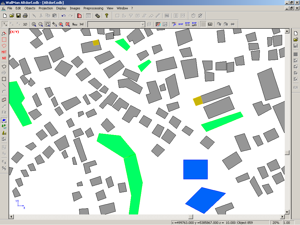

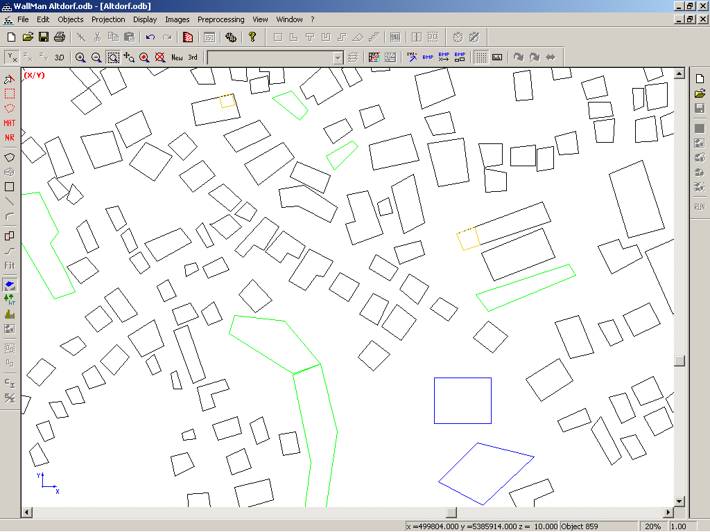

- Fill Objects
When this option is enabled, all objects in the 2D views are filled with grey color. In indoor mode, only the objects that are parallel to the current view plane are filled. This is very convenient to distinguish between vertical and horizontal objects. In urban mode, the filled mode is the better view for printouts. However, some information might be lost, for example, courtyards are not displayed any more.
Figure 3. Filled mode off (urban example) .
Figure 4. Filled mode on (urban example).
