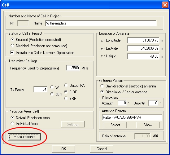

The Measurements button is used to assign a measurement file
(.fpp, .fpl, .fpf
files are supported) to the selected transmitter. The measurement file must contain
measured data from the selected transmitter only. Superposed measurement data from
several transmitters is not supported. When the measurement data is in path loss
format (.fpl) cable loss must not be included. In contrast to
this, cable loss is expected as included
when measurement data is available
in field strength or power file format. Antenna gain is always expected as
included

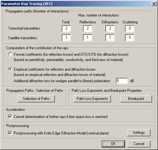

The range of the model parameters can be defined in the Settings dialog. As larger the range is, as longer the calibration will take. The model parameters depend on the selected propagation model. Each model offers individual model parameters. The following screenshot shows model parameters for the urban intelligent ray-tracing.
The model parameters can be modified on the dialog.
