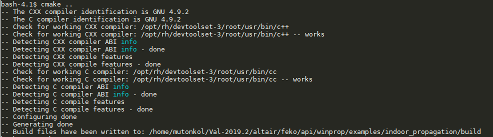

  3. Set up the project and create a make file by executing:
    cmake ..
    Figure 1. A sample of the output after executing cmake.
