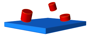

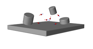

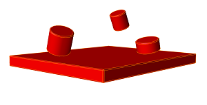

Sets are used to simplify creation of contacts, as shown in the following examples. You would typically define contacts by selecting parts one by one, but you can use a different method of selection such as By Material or By Rigid Group to quickly select several parts with a single click.
Figure 1. Example 1: All parts are placed in the red set.
Figure 2. Example 1: Contacts are created between every possible combination of parts in the red set. (The image below shows what you see when the Individualize option is selected.)
Figure 3. Example 2: Parts are placed into both the red and blue sets.
Figure 4. Example 2: Contacts are not created between parts in the same set, but are established between parts in the different sets.

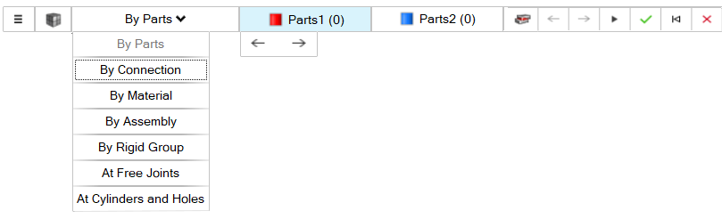

  4. Select what method to use to place parts into sets using the guide bar.
  5. Select parts to place in the first set. Use the Ctrl key to add or remove parts to a set. The part counters on the guide bar are updated as you add and remove parts from the sets.
    Method Part Selection
    By Parts Select parts one by one to add to them to a set.
    By Connection Hover the mouse over the model; parts that are connected together will be prehighlighted. Click it, and these parts are added to the set.
    By Material Hover the mouse over the model; parts that have been assigned the same material will be prehighlighted. Click it, and these parts are added to the set.
    By Assembly Hover the mouse over the model; parts that belong to the same assembly will be prehighlighted. Click it, and these parts are added to the set.
    By Rigid Group Hover the mouse over the model; parts that belong to the same rigid group will be prehighlighted. Click it, and these parts are added to the set.
    At Free Joints This method finds part pairs associated with free joints. Use the navigation arrows on the guide bar to jump from one part pair to the next. When using this method, both sets are populated for you. If there are no free joints in your model, no part pairs are presented.
    At Cylinders and Holes This method models solid cylinders inside circular holes with an analytical solution rather than a mesh-based solution. Using geometric primitives like this can improve the efficiency of the solution.
  6. When using a second set, click Parts2 on the guide bar and select parts to place in the second set.
    Note: You can use different methods to define the red and blue sets. For example, you can use By Materials to define the first set and By Parts to define the second set.

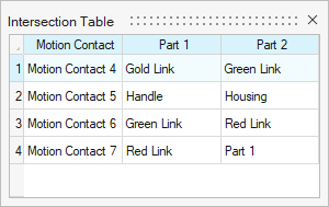

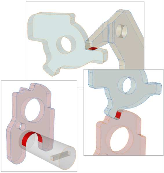

  8. Optional: Find and review initial intersections between contacting parts.
    Note: Initial intersections between parts can present difficulties in solving contact models and affect the accuracy of results. It is not mandatory that the intersections be removed before running the simulation; a contact model with some minor overlaps may still solve without having any adverse effect on results. Plotting the initial contact force and contact penetration can help you decide whether the intersection should be removed. However, if parts defined in a contact are intersecting at the start of the simulation, it could cause the simulation to run more slowly and/or display erratic behavior between the contacting parts.
    1. First, make sure that the following criteria are met:
      • There must be a contact defined between the parts.
      • The contacting parts must be visible.
    2. On the guide bar, click Find Initial Intersections.
    3. A new guide bar appears. The first button says Intersections (n), where n equals the number of intersections found. To review the intersections, click the following buttons:
      • Go to Next: Go to the next intersection.
      • Go to Previous: Go to the previous intersection.
      • List Intersections: Display the Intersection Table, which lists the intersecting parts of all visible motion contacts in the model. Click on a name in the table to review the corresponding intersection in the modeling window.
    One part has a blue dotted outline, while the other part has an orange dotted outline. The intersection is displayed in red.

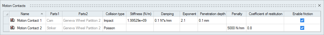

Motion Contacts Table
The Motion Contacts table lists all of the motion contacts in your model including the parts in each contact set and various other parameters.
Location: Motion Contacts tool, satellite icon
Figure 5. Motion Contacts Table
To Do this
Rename a motion contact Select the cell in the table and then click again to make the field editable.
Change the collision type Select the cell in the table and then select a different option from the list.
Edit a parameter Select the cell in the table and then click again to make the field editable.
Sort a column Click the column header. Click repeatedly to toggle between ascending and descending order.
Add or remove columns Right-click on a column header.
