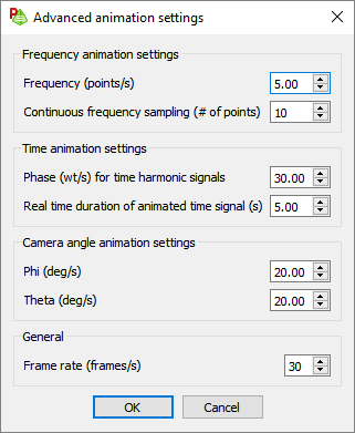

Advanced Animation Settings
Specify the speed and resolution with which a variable animates when animating a property.
On the 3D View
contextual tabs set, on the Animate tab, on the
Settings group, click the
Animation settings icon.
Frequency Animation Settings
- Frequency (points/s)
- Specify the animation speed.
- Continuous frequency sampling (# of points)
- For continuous frequency models, the frequency range is broken into a number of discrete steps, thereby specifying the sampling resolution.
Time Animation Settings
- Phase (wt/s) for time harmonic signals
- Specify the phase increment per second.
For example, setting phase (wt/s) = 30° will result in the phase incrementing by 30° each second and a complete 360° loop in 12 seconds.
- Real time duration of animated time signal(s)
- Specify the time duration of the animation before it starts to loop.
Camera Angle Animation Settings
- Phi (deg/s)
- Specify the phi angle for the camera angle during animation.
- Theta (deg/s)
- Specify the theta angle for the camera angle during animation.
General Settings
- Frame rate (frames/s)
- Specify the rate at which the consecutive images are displayed.
