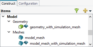

Note:
- The
icon indicates a mesh part or model mesh. - The
icon indicates that a mesh instance has already been created or defined. This mesh
instance is used when simulating the model.
