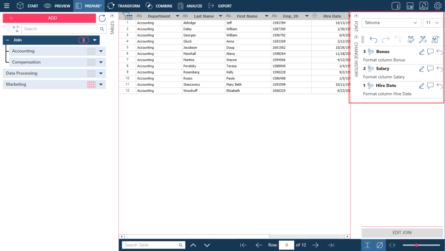

By default, the Change History panel is displayed when in the Prepare window. If your Change History panel is collapsed, select it to expand it.
The Change History panel displays:
Review your history of changes. If you want to undo an operation, select Undo Change
beside that operation.
Note that selecting Undo for one operation will also undo all operations after it. This means if you undo change #5 in a 10-item Change History list, changes #6 to #10 are also deleted.
To hide the Change History panel, click Change History once more.

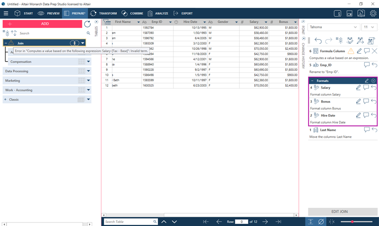

Grouping changes in a Change History list
You can group multiple changes made to a single column or multiple instances of the same change into groups to avoid creating excessively long Change History lists.
Using CTRL + Click select all of the changes you want to include into a change group from the Change History list.
Right-click on your mouse and, from the options that display, select Add Changes to Group.
The Create Change Group dialog displays. Enter a name for the change group you wish to create and then click OK.
The change group displays as below:
Clicking the Collapse change group
tool in the change group header minimizes the group.
NOTE: You can also ungroup changes by right-clicking the change group header and selecting Ungroup Changes from the context menu.
