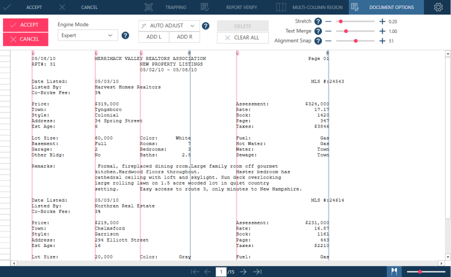

Selecting Auto Adjust > Force Left clears all right alignments and adjusts the text so that they are left-aligned.

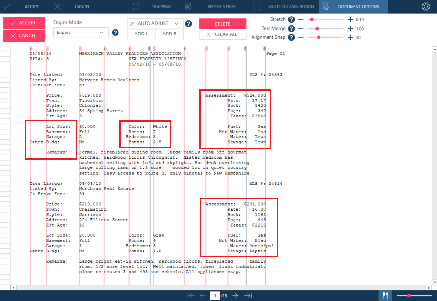

If Auto Adjust > Force Left is unable to align the text in a satisfactory manner, other manual adjustments may be applied.

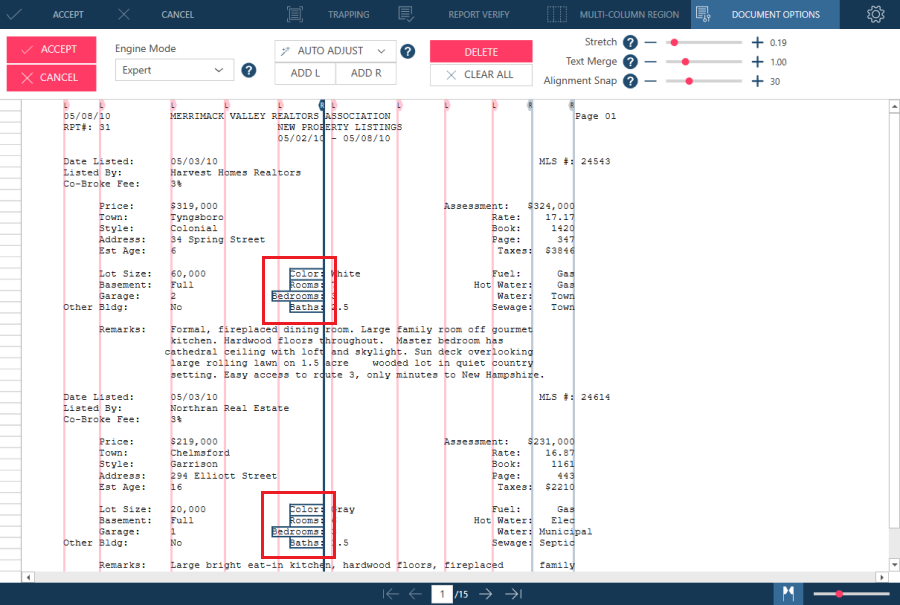

For example, note the lack of alignment in the text below.
To adjust an alignment, click on the alignment of interest. When a right (R) alignment is selected, the text aligned with this alignment is highlighted in blue. On the other hand, when a left (L) alignment is selected, the text aligned with this alignment is highlighted in red. Use your keyboard's left or right key to move the alignment left or right, respectively, as necessary. You can also use your mouse to grab an alignment and drag it to your desired location. Note that because alignments of the same type at exactly the same location are not meaningful, an alignment cannot be moved to the same position as another alignment of the same type. However, you can add both a left and right alignment to the same position.

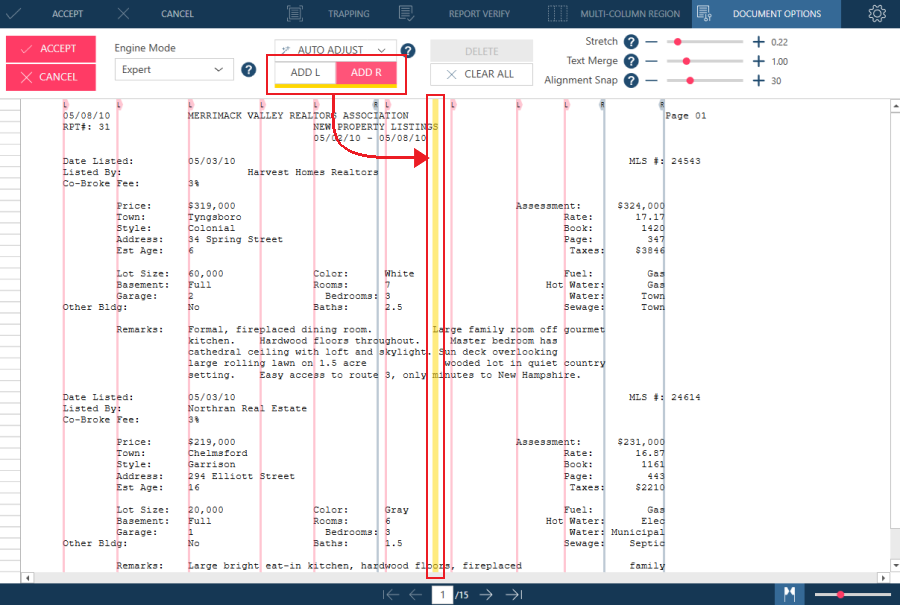

If you require a new alignment, click the point in the report in which this alignment must be added so that a vertical yellow line appears. Select Add L or Add R to add a left or right alignment, respectively, as necessary.
Alternatively, you can hover over the position in the report in which you wish to add an alignment, right-click on your mouse, and then select Create Left/Right Alignment Here.

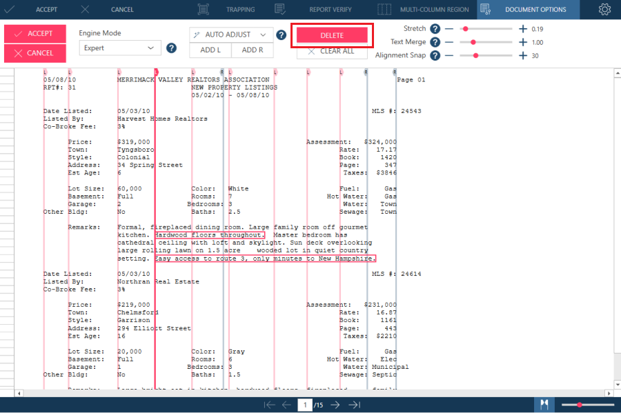

If a vertical alignment is unnecessary, select it and then click Delete.
Alternatively, you can right-click on the alignment and select Delete from the options that display.

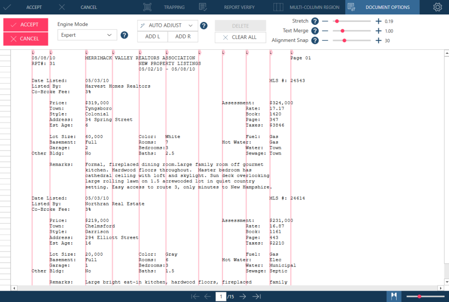

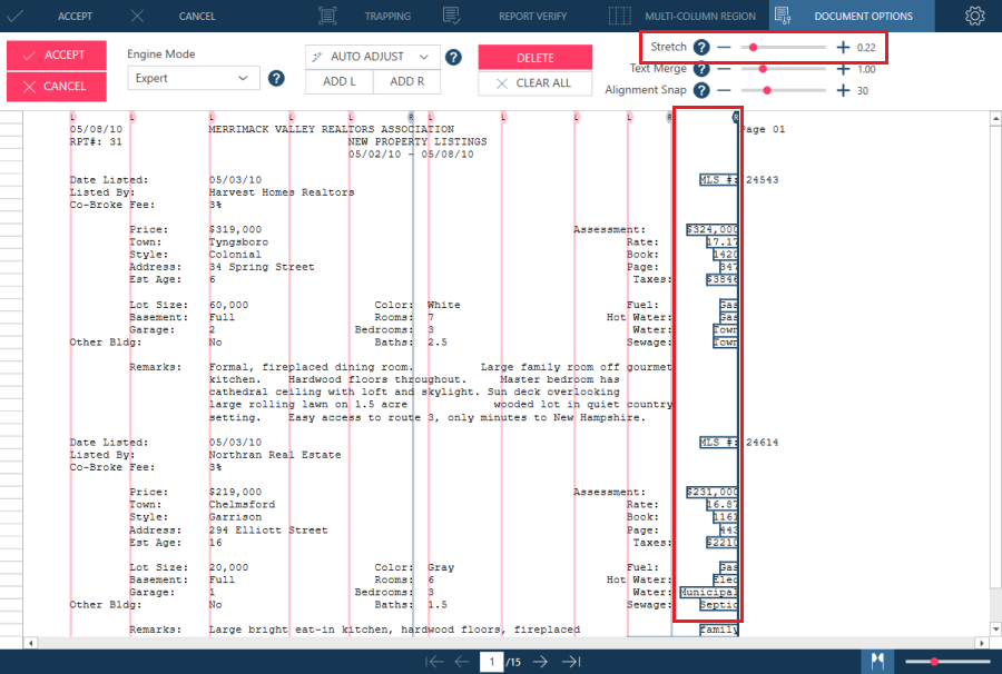

Using the Stretch Property
Text spaced too closely together can lead to difficulties in implementing manual adjustments. Stretch can be used to pull the text farther apart to address this issue. In the figure below, note how adjusting the Stretch setting enables the alignment of all values in the right-most part of the report.

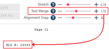

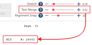

The property Text Merge specifies how closely text fragments should be brought together to form groups or sentences. The default value for this property is 1.
In this example, a small Text Merge value is used. The space between MLS and #: is fairly large because the merging of text is reduced.
In this example, a large Text Merge value is used. Compared with the previous example, the space between MLS and #: is reduced because the merging of text is increased.

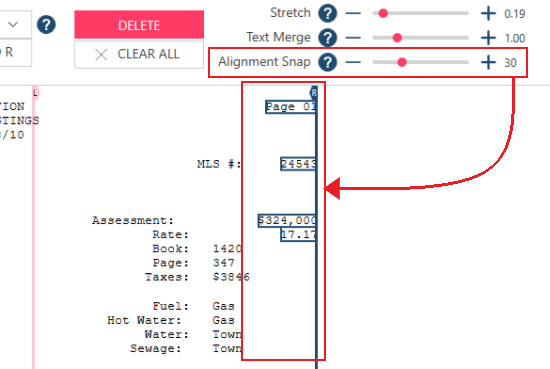

The property Alignment Snap controls the distance, both to the left and right, an alignment can reach to grab text to align with it. Higher values for this property instruct the application to pull text farther away from an alignment toward it.

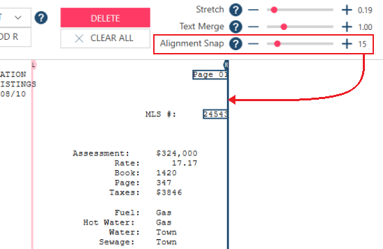

Take the following image as an example. Here, an existing left alignment is positioned to the left of the word Assessment. No right alignments exist.
If the default Alignment Snap value (i.e., 30) is maintained and a right alignment is added immediately after Page 01, other groups of text close to the new alignment are pulled to it.
Using a lower value for this setting (e.g., 15) pulls only two lines of text to the right alignment as other values are considered too far from it.

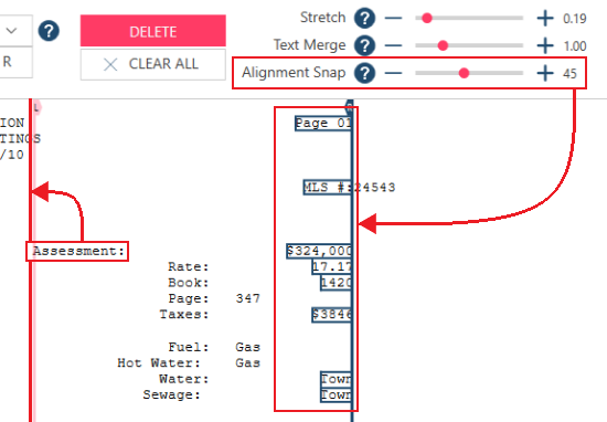

Using a higher value for this setting (e.g., 45) pulls more lines of text toward the right alignment. Note also how the word Assessment: is pulled toward the existing left alignment, which is expected as the Alignment Snap property pulls text toward the nearest alignment, regardless of its type.
Once a text fragment has been pulled to an alignment, no other fragments can be pulled to the same alignment even if a larger Alignment Snap value is used.
