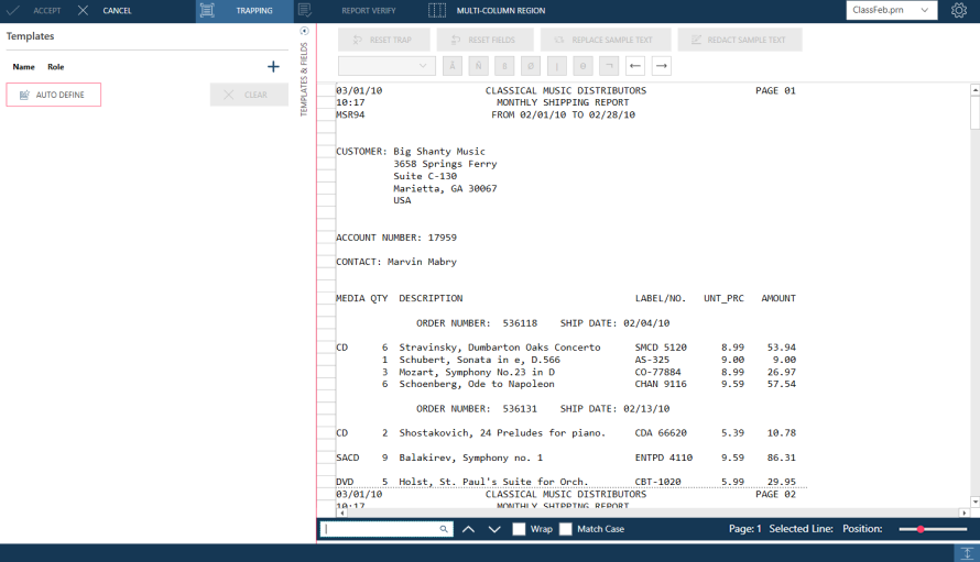

Step 1: Identify and select a template sample
Import a PDF or PRN report into Data Prep Studio. If the imported file is a PRN report, the Report Design window immediately displays.
If the imported file is a PDF report, the PDF document options window displays. Once all document options have been appropriately set, the PDF document is opened in the Report Design window.
Inspect the first few pages of the report to identify the detail level information. Note whether all detail fields fit on a single detail line or if they spread across multiple lines. In most reports, all detail level fields fit on a single line. However, occasionally, the detail fields may be arranged in blocks of two or more lines, sometimes with field labels interspersed.

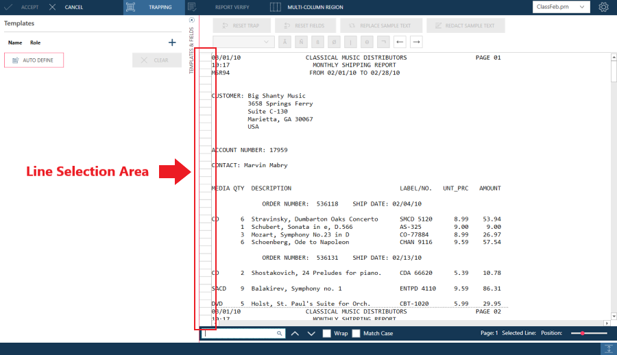

Select a line or group of lines that contain a single instance of the detail fields. To select a single line, click in the line selection area to the left of the line. To select multiple lines, click down in the line selection area to the left of the first line, then drag down to the last line, then release.

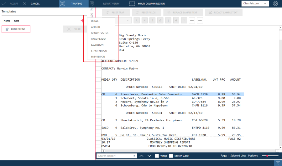

In the Template and Field Properties Panel, select Add a New Template
and then select a template role:

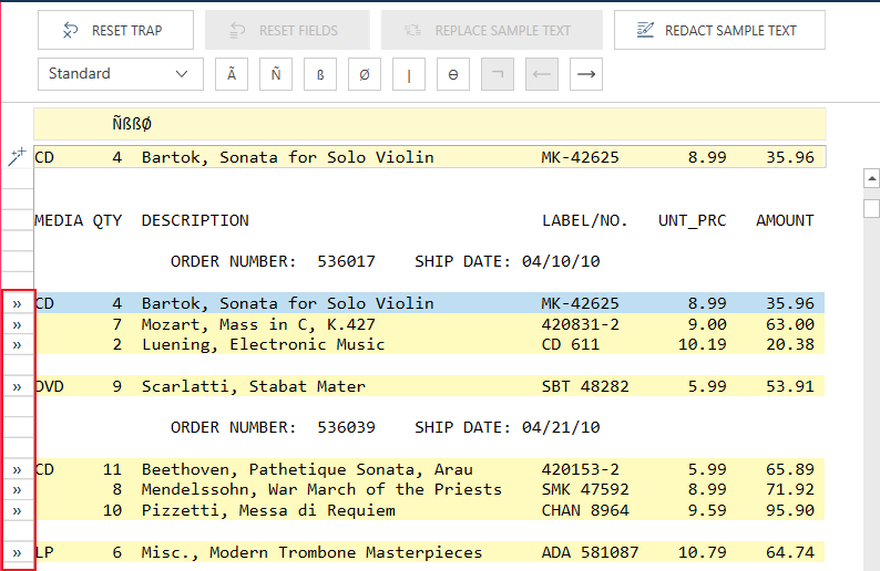

Each template requires a trap that identifies unique features of the template. The trap is used to capture all instances of a template throughout the report. In the case of a detail trap, the trap identifies common features shared by all detail lines, but not shared by other lines. A proper detail trap will capture only the detail lines while ignoring lines from headers and other sort levels.
For example, in the illustration above, all detail lines have a number in position 9 followed by two blank characters:
To capture these lines, you can set a trap that looks for a numeric character in position 9 followed by two blanks.

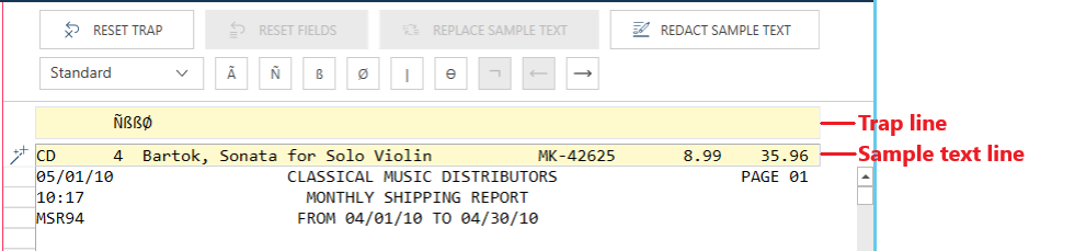

You create a trap by entering trap characters in the trap line, as shown below:
The Sample text line and the Trap Line. The Trap Line has one numeric trap defined.
As you create your trap, portions of the body of your report are marked with guillemets in the line selection area to confirm that the data in them will be captured. You can use these marks to check that your trap is correctly defined.
You can specify one or more trap characters on the trap line. Often, several different combinations will work equally well. It is generally a good idea to specify several trap characters to ensure that you do not accidentally capture lines from other sort levels, but be careful. If you specify many trap characters, you run the risk that some lines will be missed by the trap. You can experiment with the trap definition until you find a combination that works.

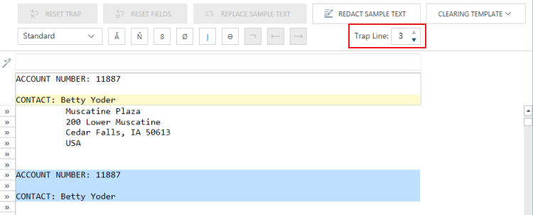

In some reports, the detail fields are arranged on more than one line, e.g., a block of text. As well, occasionally, there may be no unique features that identify the first line of a block of text. If it is impossible to use line 1, select another line that has unique features. In this case, you need to indicate which of the sample lines to trap on via the Trap Line option.

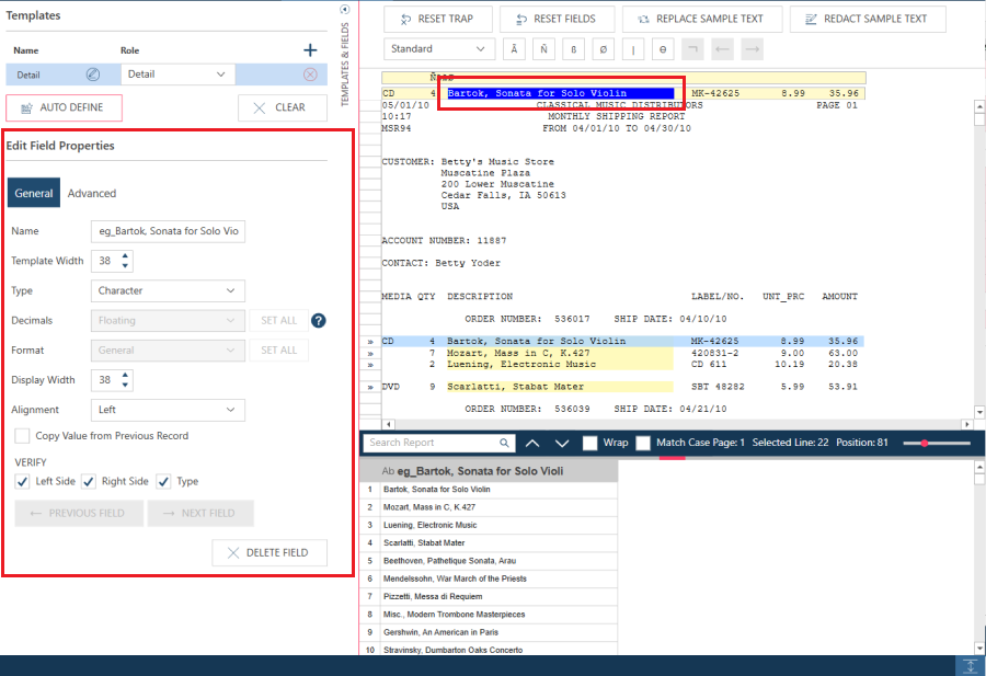

Highlighting fields
Using the sample line as an example, highlight each field you want to extract. Each field highlight should be long enough to allow for long field values but not so long that you extend the highlight into another field's data. For numeric fields, which are right aligned, the highlight should extend to the left to account for the largest number that is likely to exist in the field.
Using the mouse. Click down in the Sample text line at the left extent of the field and then drag right to highlight the field. Repeat for each field you want to extract. For numeric fields, which are right aligned, you may start at the right edge and drag left to highlight the field.
Using the keyboard. The keyboard provides a more precise method of highlighting fields, since you can easily adjust the field length by a single character at-a-time. Click in the Sample text line to display the insertion cursor. Use the arrow keys to move the cursor to the first character in the field, then press Insert and use the right arrow to highlight the field. Press Enter to complete the field definition. Repeat for each field you want to extract.

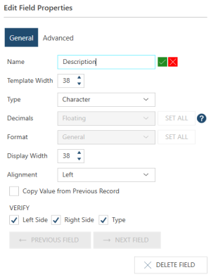

You can name each field via the Field Properties portion of the Template and Field Properties panel. By naming fields within the context of the report, you may find it easier to determine appropriate field names.
Click a field you wish to rename in the Sample text line.
The Field Properties portion of the Template and Field Properties panel displays the sample field value for the selected field along with the current field name. If you have not yet named the field, it is automatically given a temporary name.
Create an appropriate name for the field by clicking into the Name box and replacing the current entry with a new one. Click on the checkmark that displays next to the field to accept the field name.
Field names may be up to 62 characters in length and may contain uppercase and lowercase characters, spaces, and punctuation except for period (.), exclamation point (!), accent grave (`) and brackets ([]). Names may begin with any character, except for an underscore or space. If a name is entered with leading spaces, the name is accepted but the leading spaces are ignored.
Note: If you elect to enforce DBF field naming rules, field names must adhere to the dBASE III field naming conventions. Names may be up to ten characters long and may contain any letter or number and the underscore character (_). The first character must be a letter. Spaces and punctuation are not allowed.
Repeat steps 1 and 2 for each field to be named. If several fields are defined in one template, you can display the properties of the next field and rename it by selecting the Next Field button at the bottom of the Edit Field Properties panel.
