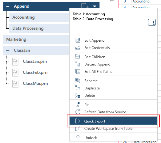

Quick Exports - These exports are set up from the Prepare window via the table list context menu or by right-clicking on a table in the Export window. Quick exports are not saved with the workspace.

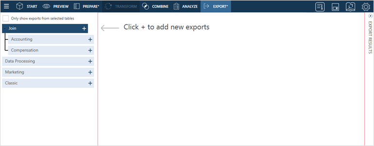

Select Export from the Data Prep Studio toolbar.
The Export Window displays:
Click the Add Export
button located to the right of the table you wish to export and, from the options that display, select an export format.You can export tables to the following formats:

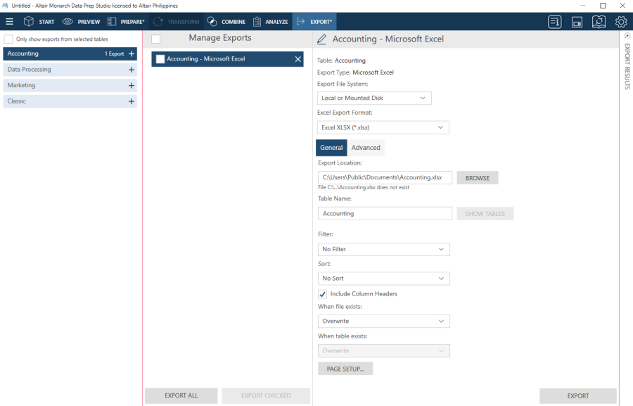

The table you selected displays in the Manage Exports panel and its properties display in the Export Properties panel.
Rename the export if you wish by clicking on the Edit
button located to the left of the Export name (in the figure above, "Accounting - Microsoft Excel") and then entering a new name into the field. -
Specify general export options as necessary. Your export options will vary depending on the export type. The table below describes these settings.

Excel Export Format
Microsoft Excel
This setting specifies what file format to apply when exporting to Microsoft Excel files. The advanced properties you can set will depend on which format you select.
.xls
.xlsx
.xlsm

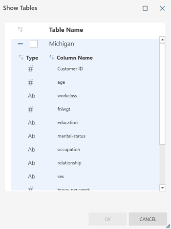

Show Tables
Microsoft Excel
Microsoft Access
Panopticon
When exporting a table to a file that already exists, this setting allows you to see the destination file’s existing tables and columns and select the table to which the data should be appended or overwritten. When a table from the Show Tables dialog is selected and confirmed, the name of the selected table is inserted into the Table Name textbox and the current content of this box is overwritten.
The tables displayed in the Show Tables dialog may be sorted by name by clicking on the sort icon in the header. The tables have an expander button that allows you to view a list of columns belonging to that table.

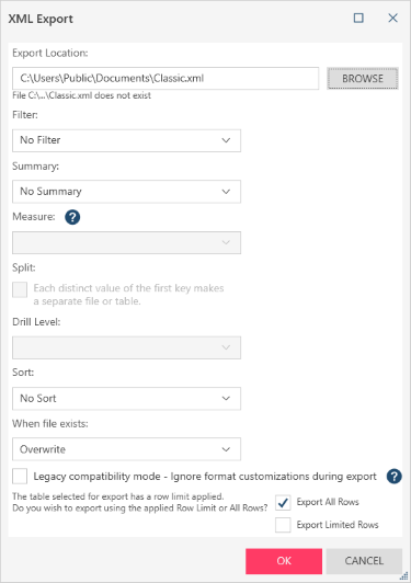

Export All / Limited Rows
Microsoft Excel
Microsoft Access
CSV
Fixed Text
JSON
XML
Microsoft Power BI
IBM Cognos Analytics
SAS Transport File Format (XPORT) Version 5
Altair Knowledge Studio
Tableau TDE
Tableau Server
Qlik
Altair Panopticon
For tables with defined row limits, this setting specifies whether the defined row limits should be respected during export. Select the appropriate checkbox to instruct Data Prep Studio to export all rows or only those rows that fall within the limit you have set.
