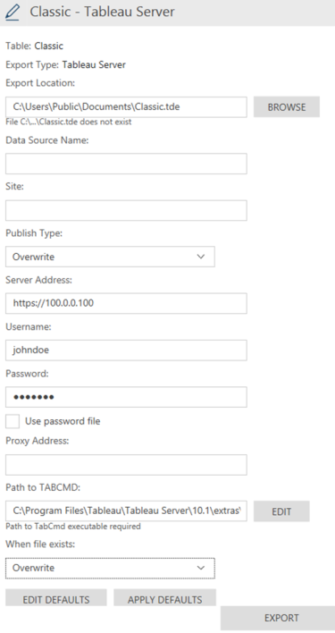

Confirm the details of the indicated Tableau Server (the information here will depend on the server details you indicated in the Application Default Settings dialog) in the Export Properties panel.
Enter all of the required information:
Field
Export Location
Specify a path and name in which to export the .tde file.
Data Source Name
Enter a name for the data source. This will be the name that will be displayed on the server.
Site
Leave this blank.
Publish Type
Select an action to perform if the table you are publishing already exists in the server:
Overwrite
Append
Replace
Filter
Specify a filter to apply to the table, if applicable.
Sort
Specify a sort to apply to the table, if applicable.
When file exists
Select an action if the file you are exporting to already exists in the export location specified:
Overwrite
Skip
If you wish to export your table to a different server site, you can modify the details specified in the server fields, including server address, username, password, and path to the TABCMD utility. To revert to the default values provided in the Application Default Settings dialog, click the Apply Defaults button. If you wish to edit your default values, click the Edit Defaults button instead. Note that the path to the TABCMD utility, by default, cannot be edited from the Export window. The path to this utility can only be edited in the Application Default Settings dialog.
Click the Export button when you are ready to export.
