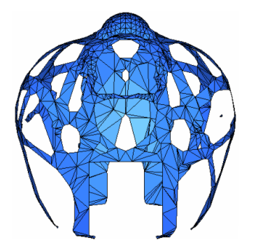

Interpretation of Topology Optimization Results
The purpose of this functionality is to provide an iso-density surface based on the volumetric density information of a topology optimization, which is conducted using OptiStruct.
#general parameters
input_file mattel
output_file mattel.stl
output_code 3
#specific parameters
isosurface 1 3 0.300
laplacian_smoothing 10 30.000 1
surface_reduction 1 10.000
The parameter laplacian_smoothing
is used for additional smoothing. In most
cases, the threshold surface (isosurface with second argument 0
) already
creates a smooth shape. Additional smoothing (isosurface with second argument
3
) maintains the topology as suggested by OptiStruct, but
it can deviate from the given density distribution. If this option is used, the maximum and
average smoothing error output by OSSmooth should be checked. The
surface_reduction
parameter is used to reduce the number of elements.

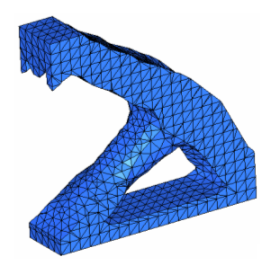

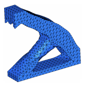

Laplacian Smoothing
Used in the smoothing of the results of topology optimization.
laplacian_smoothing
statement controls the iteration number of when the
Laplacian smoothing will be performed and the feature angle threshold to
preserve normal discontinuity at corners. One smoothing result is shown
below with the following parameter setting in the OSSmooth parameter
file.#general parameters
input_file surf
output_file surf.stl
output_code 3
laplacian_smoothing
statement in OSSmooth include:
- The flexibility of controlling the number of smoothing iterations to obtain different degrees of smoothing (possibly a smoothing quality ready for casting). Normally, the iteration number ranges from 5 to 20.
- Smooth boundary of iso-surface with feature angle constrain are seamlessly incorporated into the smoothing process, which is more challenging in a pure CAD system.

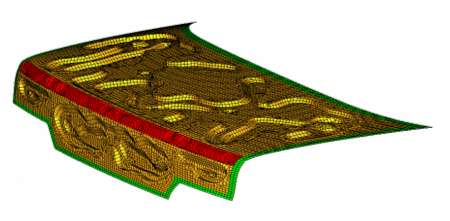

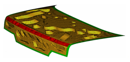

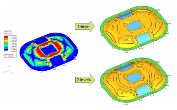

Interpretation of Topography Optimization Results
The autobead feature of OSSmooth allows OptiStruct topography optimization results to be interpreted as one or two level beads.
#general parameters
input_file decklid
output_file decklid.fem
output_code 1
autobead 1 0.300 1
remesh 1
#general parameters
input_file decklid
output_file decklid.nas
output_code 1
autobead 1 0.300 2

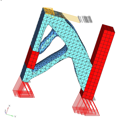

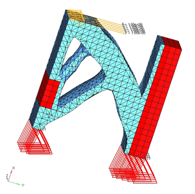

FEA Topology for Reanalysis
The purpose of this functionality is to provide an iso-density surface based on the volumetric density information from a topology optimization.
Through tetrameshing for 3D models and inheriting boundary conditions, the results from FEA topology can be used for quick reanalysis.
FEA topology support is available for first and second order shell and solid elements. For 3D models, the recovered iso-surface can be tetrameshed-by-property automatically. FEA topology provides two options for the processing of non-design elements: Keep smooth narrow layer around and Split all quads. Keep smooth narrow layer around will retain an artificial layer of elements around the non-design space in the interpretation and Split all quads will split quad elements in the non-design space, if present, to generate a tetra connection between design and non-design regions. Finally, FEA topology preserves boundary conditions by inheriting them from the original model (<prefix>.fem). Those boundary conditions unattached to nodes/elements after geometry recovery are deleted to ensure reanalysis.
file | block |
density threshold | 0.300 |
Keep smooth narrow layer around | off |
Split all quads | on |
- Tetramesh can be performed by property.
- The flexibility of controlling the number of tetramesh retries by perturbing the density threshold value, in cases where tetramesh sometimes fails.

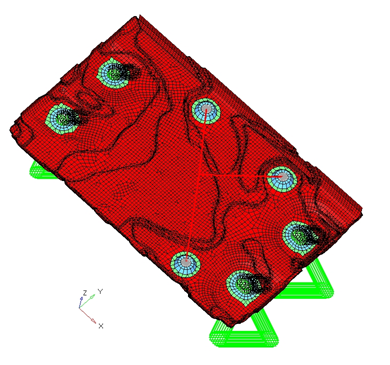

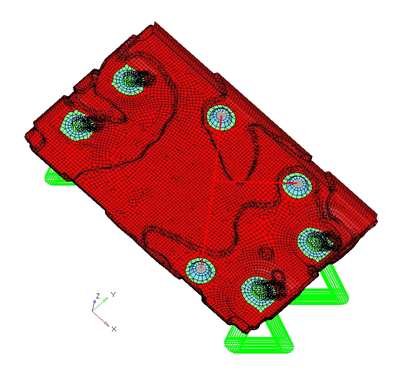

FEA Topography for Reanalysis
The FEA topography option in OSSmooth allows the results from an OptiStruct topography optimization to be interpreted as one, or two-level beads and recover boundary conditions upon geometry extraction.
Grid file | brkt |
Threshold | 0.300 |
Layers | 1 |
Grid file | brkt |
Threshold | 0.300 |
Layers | 2 |
