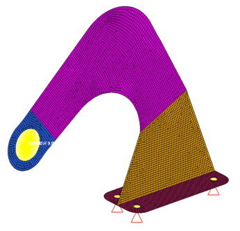

In this tutorial you will perform a topology optimization on a bracket-hook modeled with shell elements.
The structural model is loaded into HyperMesh Desktop. The constraints, loads, subcases and material properties are already defined in the model. The topology design variables and the optimization problem setup will be defined using HyperMesh, and OptiStruct is used to determine the optimal material layout. The results can then be reviewed in HyperView.

In this step you will set the optimization to optimize the shell elements in the Design and Base components to create structural members with minimum member size of 1.0 unit in width with thicknesses that vary between zero and the thickness of the shell. The optimization will use 1000 as the maximum stress for any element within the design region when validating the design.

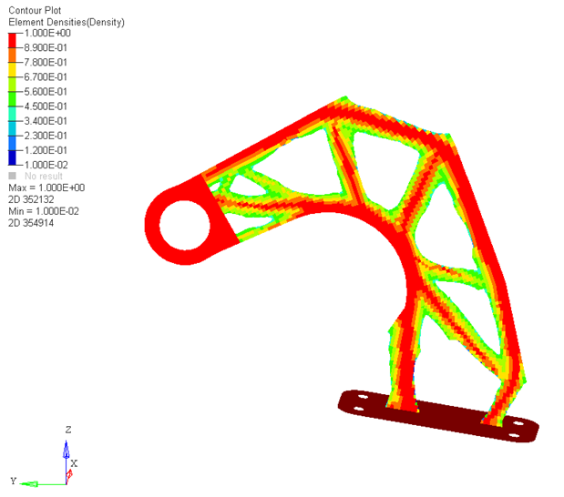

Review the Contour plot of element density results.
From the Results toolbar, click
to open the Contour panel.

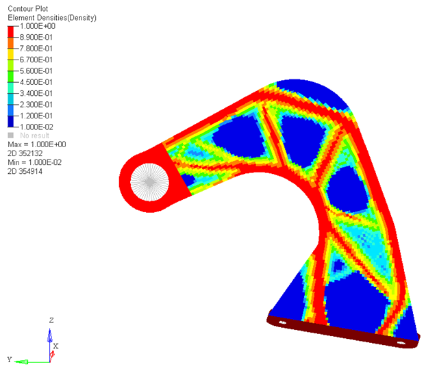

- Set the Result type to Element Densities[s].
- Click Apply to display the density contour.

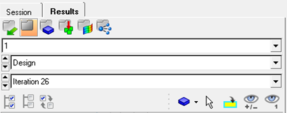

- In the Results Browser, select Design and Iteration 26 (or your final iteration number).
Review the Iso Value plot of element density results.
Figure 4. Iso Value Plot. Current value=0.4528

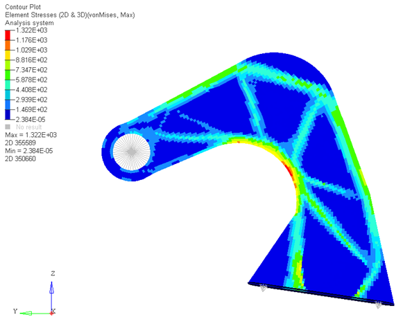

- Set the Result type to Element stresses(2D&3D)(t) and vonMises.
- In the Results Browser, select the last displayed Iteration.
In the Contour panel, click
Apply.
Figure 5. von Mises Stress Results
- Similarly, review the results from the other subcases.
You will notice that there are some local regions where the stresses are still high; this is because topology stress constraints should be interpreted as global stress control or global stress target.
