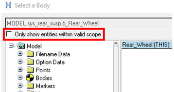

  18. Under Connectivity, change the Force type to Action reaction and Properties to Rotational. Select Rear_Wheel as Body 1, SwingArm as Body 2, and Wheel_Center as Point 1.
    Figure 19.
    Note: If the entities selection is not available, clear the option Only show entities within valid scope.

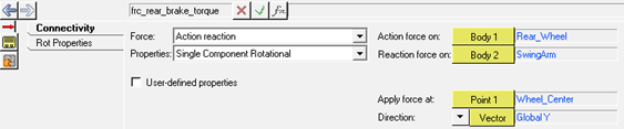

  6. Click on Rear Brake Torque. Under Connectivity, change the Force to Action Reaction, and Properties to Single Component Rotational. Select the Rear_Wheel for Body 1, SwingArm for Body 2, Wheel_Center of the rear wheel for Point 1, change the Direction to Vector and select Global Y.
    Figure 27.
  7. Under Rot Properties, change T: to Expression and enter: `VARVAL({sv_brake.idstring})*10000`.

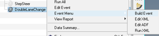

  2. Right-click on Model > Add Events. Select Double Lane Change, Label = DoubleLaneChange, and Variable = event_DLC, and click on OK.
  3. Right-click on the DoubleLaneChange event, under Event Menu select Build Event.
    Figure 45.
    The Build Event will generate the necessary files to simulate the model.
