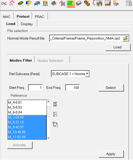

The PreTest utility's Load tab allows you to select and load the normal modes results
files and filter modes and also select nodes for PreTest and Driving Point Residue
calculations.
Modes Filter
Using the Modes Filter tab, you can select modes from selected subcases, defining a
frequency range, or by filtering the frequency values manually.
Figure 1. PreTest - Load Tab - Modes Filter
