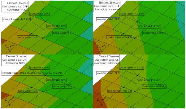

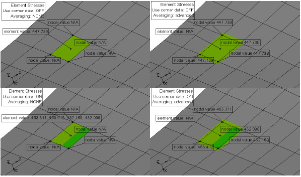

  4. If corner data is available, choose if a nodal or element value should be used by checking/unchecking the Use corner data option (see the element stress examples below).
    Averaging: None Averaging: Simple/Advanced
    Use corner data off One value per element: centroid value taken from result file.
    One nodal value for all corresponding elements: averaged from each centroid value.
    Use corner data on IP value mapped to nearest node, OR, Nodal result from result file (whichever of the two is available): values are not averaged at node.
    One nodal value for all corresponding elements: averaged using corresponding corner data values (either IP or nodal result from result file).
  5. For Selection, pick one or more entities from the model.
  6. Select the coordinate system that will be used to calculate the results from the Resolved in drop-down menu.
    Note: If User System is selected, use the System input collector to select a system by ID.
  7. Use the Averaging method drop-down menu to select the averaging type of the element contribution at the shared element node (see the element stress examples below).
    Only one element contoured: Averaging at nodes with values from that element.
    Values that are averaged at nodes have contributions from all of the attached elements.
