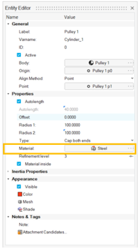

Change the Pulley Material
The pulley material can be changed by:
  • For NLFE Belt and Discretized rigid bodies, select the graphic system of the pulley and change the material attachment in the Attachments section of the Entity Editor:
    Figure 3.
  • For Substructured Flex Bodies select the Pulley graphic in the Model Browser and change the Material under the Properties section of the Entity Editor:
    Figure 4.
