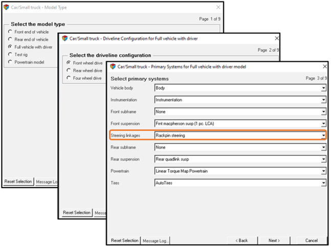

Create a Full Vehicle Model with EPAS System
The MBD-Vehicle Dynamics Tools must be loaded as a preference file.
The Update Model utility is only available when the profile MBD-Vehicle Dynamics Tools is loaded. Follow the steps below to load this profile and access the utility:
From the Menu bar, select
Figure 8. -
Choose the MBD-Vehicle Dynamics Tools profile and click
Load.
Figure 9. -
Click
Figure 10. -
In the Model Type window, select the following:

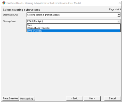

In steering subsystems EPAS (Rackpin) will be available
as a Steering boost method.
Figure 12. Other options for the model systems are left to your discretion.
Completing the Assembly Wizard’s selections will lead to a full vehicle model with Altair Driver and an Electric Power Assisted Steering System.Figure 13. Steering maneuver simulation such as Sinusoidal Steering or Step Steer events can help you understand the behavior of an EPAS system. In the following diagrams these two events are presented for the displayed event settings and the results are compared with those of a vehicle with no steering boost system, performing the exact same maneuvers.
