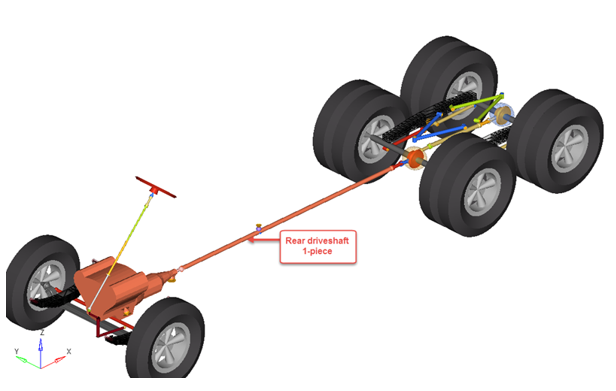

Rear Driveshaft 1-piece
A single piece driveshaft extending from the transmission in the front to the
differential in the rear via a yoke-pinion end. The driveshaft connects via a yoke
in the front to allow for vertical and longitudinal suspension movement.
Figure 3.

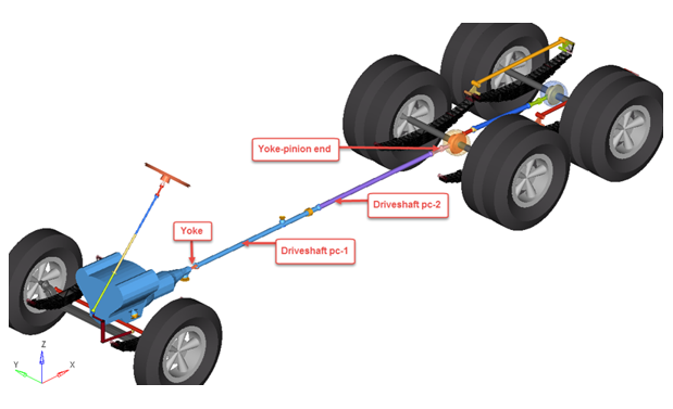

Rear Driveshaft 2-piece
A two piece driveshaft extending from the transmission in front to the differential
in the rear via a yoke-pinion end. The driveshaft connects via a yoke in the front
Figure 4.

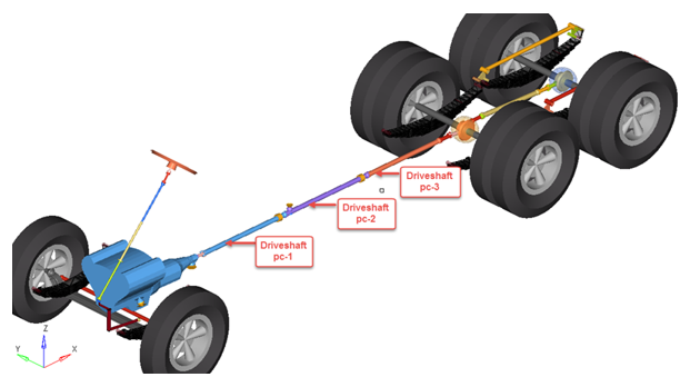

Rear Driveshaft 3-piece
A three piece driveshaft extending from the transmission in front to the differential
