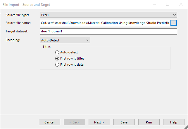

Build Predictive Model in Knowledge Studio
  1. Import doe_1_ooxml.xlsx into Knowledge Studio.
  2. Build a machine learning model of your preference. In this tutorial, Deep Learning model is selected.
