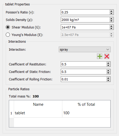

  4. Click the tablet bulk material and verify that the properties are set as shown below.
    Figure 5.

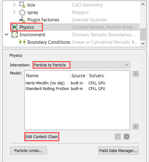

  1. In the Creator Tree, click Physics.
  2. Set the Interaction to Particle to Particle then click Edit Contact Chain.
    Figure 7.

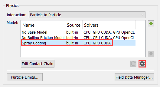

  4. In the Creator Tree, select Spray Coating and then click .
    Figure 9.

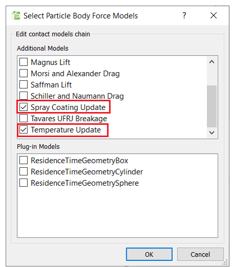

  10. In the Creator Tree, change the interaction to Particle Body Force and then click Edit Contact Chain.
    Note: In this simple example, the tablet particles are created such that there are no tablet-tablet and tablet-geometry contacts. Hence the contact models are turned off to save computational time. The spray-tablet contacts are still active and are handled by the spray coating physics model.
  11. In the dialog, activate the checkboxes for Temperature Update and Spray Coating Update and then click OK.
    Figure 12.
    By including the spray coating model in the particle body force, the target material’s volume is updated. Without this, only the target material’s Volume Added property will increase.

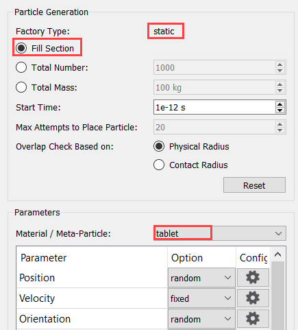

Define Geometries and Factories
  1. Under Geometries, click box and verify that the type is set to Virtual.
  2. Right-click box and select Add Factory > Add Static Factory.
    Figure 14.
  3. Set the particle generation parameters as shown in the figure below. Make sure that the Material/Meta-Particle is set to tablet.
    Figure 15.

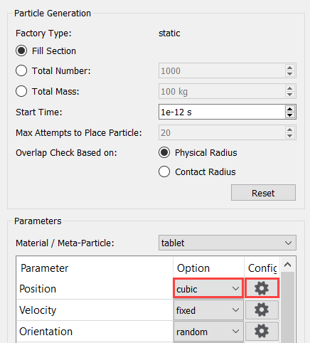

  4. Under Parameters, set the Position option to cubic and then click .
    Figure 16.

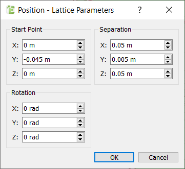

  5. In the dialog, enter the position parameters as shown in the figure below and then click OK.
    This creates a row of tablet particles spaced evenly along the y-axis and located at the center of the box.

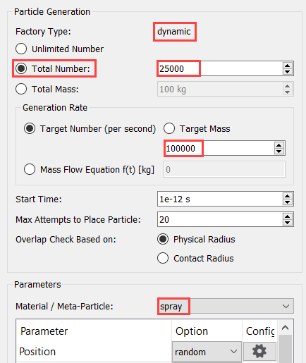

  8. Right-click spray and select Add Factory > Add Dynamic Factory.
  9. Set the particle generation parameters as shown in the figure below. Set the Material to spray.
    Figure 18.
