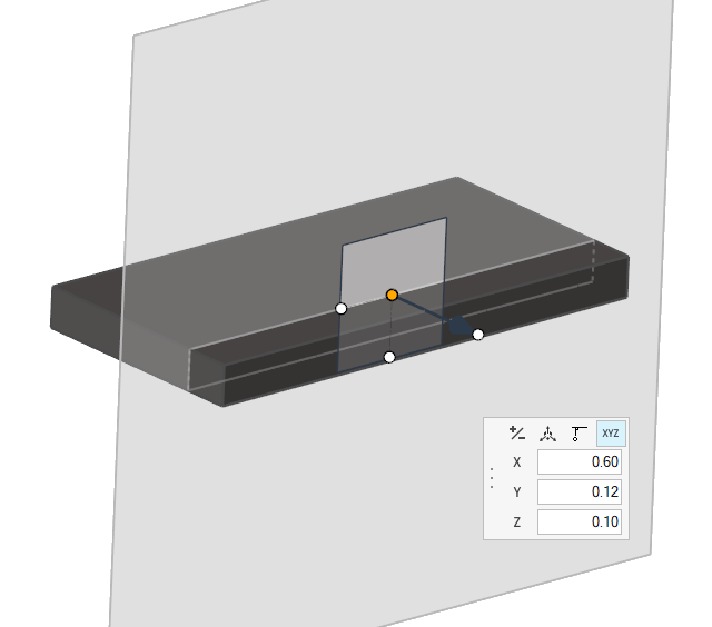

Define Nodal Initial Conditions
  1. From the Solution ribbon, click the Plane tool.
    Figure 14.
  2. Select the solid body.
  3. Click Plane on the guide bar.
  4. Click any point on the model to initially position the plane.
  5. Click in the microdialog and manually set the plane axis to Y.
    Figure 15.
  6. Click and set the coordinates to (0.60, 0.12, 0.10).
    Figure 16.
  7. Press Esc two times.
