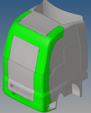

- Leading edge corner flows
- For cab-over trucks, the flow around the leading-edge corners is
important. It is suggested to isolate the parts over the full height and
set a part offset of 8 layers RL7 (3 mm) plus an offset of 8 layers of
RL6 (6 mm) on top of that.
Figure 19. Offset regions for leading edge corner flow on cab-over trucks (model source FAT)
